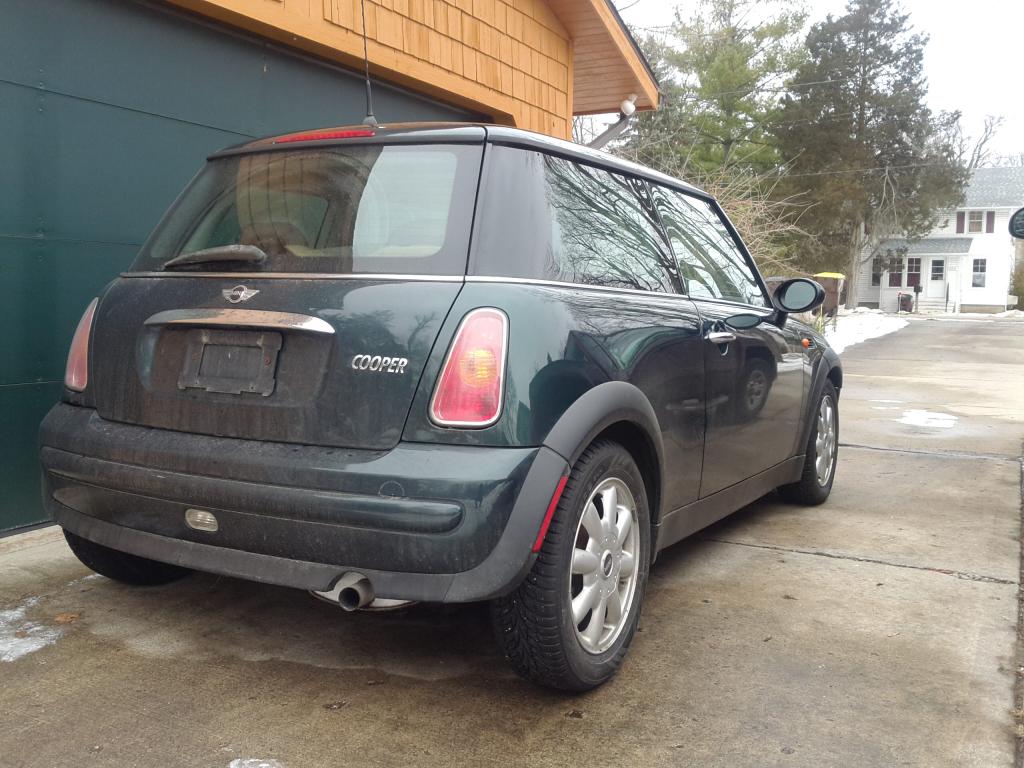

Bought a MINI to use for auto-x rally-x etc.
It's in rather rough shape, needs mostly common first year MINI stuff.
First order of business is coil, plugs, wires, pcv valve. Also I'm fairly certain it needs a head gasket.
Electric PS pump is dead (as usual) so I'll be heading to the dealer to see if they'll really fix it under those new warranty terms. If not I'm deleting that and going manual with a little conversion plate.
Motor mounts are dead, again as usual, so those are going poly
I have some cooper S suspension bits off another project for it.
Interior is trashed, but it'll be gutted anyway

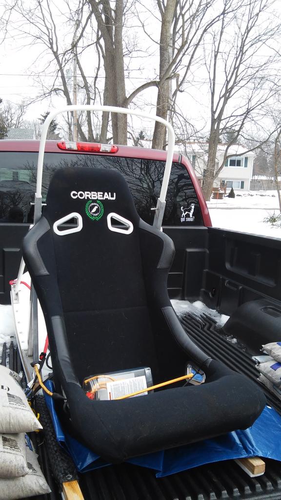

As for the plans on the interior, I'm pulling almost everything. All carpet, door cards, panels in the back, truck panel, back seats, glove box (latch is already busted), headliner, center console shifter covery thing.
Driver's seat is kinda shot, recliner mechanism issue? Either way got a seat that was sitting around in a buddy's shop Name:  20150124_123023_zpsndolrrxl.jpg

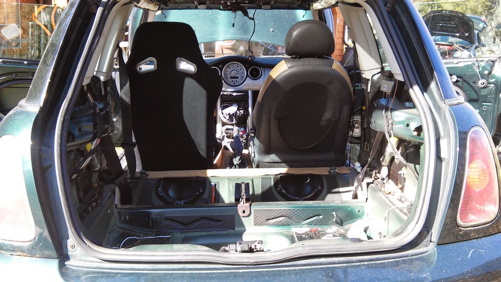

I did end up pulling out most of the interior. All panels, back seats and carpet, headliner, glove box. I'll think about how much more I want to take out. I was going to take out the front carpet, but I saw why it is usually left in, lots of bracing, not a flat floor pan at all.
Also mounted the new seat.
Hopefully I sell a car this week so I can pull the head this weekend.

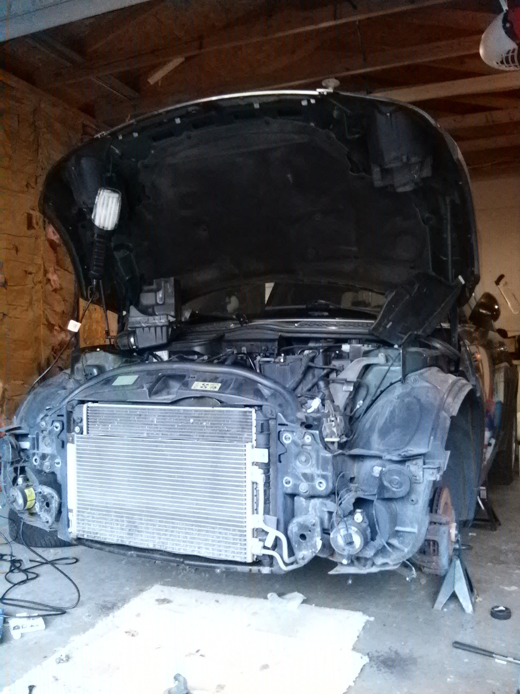

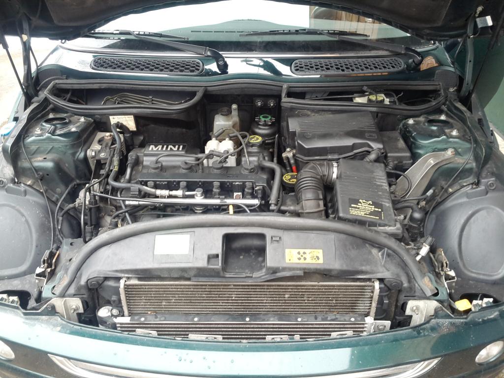

Finally got caught up on my flower gardens and firewood, started working on the MINI again this weekend. Got some 205/45/15 Nittos for it, and finished the wheels bronze.
Then I pulled down the front, deleted the power steering, drained the coolant. Inspected the front suspension, made some notes on what to change/adjust. I'll prob only do a couple hours at a time, but at least I've started.
Also, MINI really should have put a drain on the radiator, that was annoying.

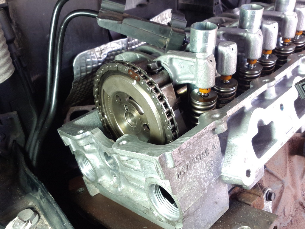

I did get the head pulled, it was really pretty easy once I made a little space, a couple hours a night and I had I had it done in like 3 nights. That includes pulling to front access, removing everything but the motor from the engine bay and getting the head off. It's actually been quite relaxing.

The unfortunate part is that after pulling the head it turned out that the issue is burnt valves... buuuut the cylinders look fine, and it's not really that bad of a fix $$ wise for my machine guy.
So I'm trotting right a long, may even race this season... Valves should be here on Monday, and I'll take em over to the shop.

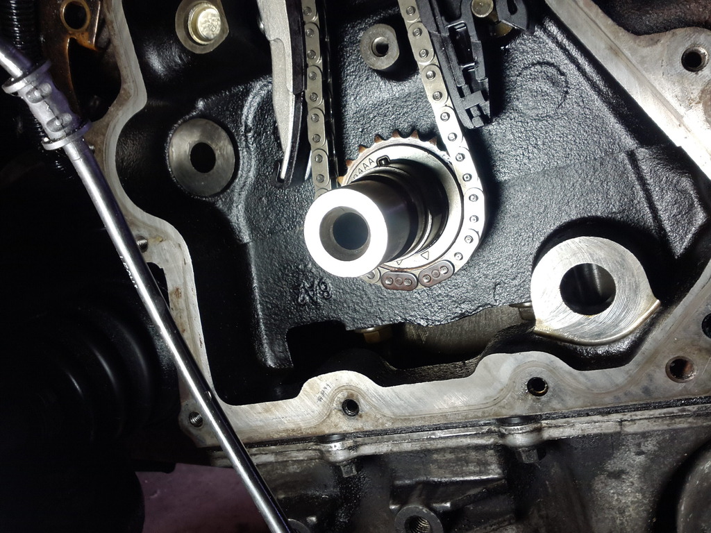

Been a while since I updated. Taking it slow, I only really work on it a couple hours at a time here and there. Keeps it fun instead of stressful.
Got the head back, and put it all back together. While I was at it I pulled the front cover and set the timing since the head had def been off before I bought the car. After finding the shifter "fix" I wasn't in a trusting mood. I also deleted the A/C, filled all the motor mounts with urathane, and installed a WMW crank pulley.
It's just about ready to be started, but I'm going to change all the font end bushings while I have it torn apart... soooo maybe this weekend or next weekend I'll be done.

As a test here are the filled engine/trans mounts:
A/C gone:
WMW Pulley on:
Timing set:
Motor 90% back together:
Bonus, painted my tow dolly to match the Cooper:

Small update. Finished rebuilding the front end. I'll probably work on the car a bit this weekend. I want to change the passenger axle while everything is torn down. My plan is to change the axle and put the front end back on. Maybe it'll be ready to run on Sunday.
