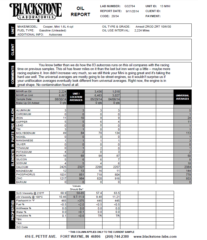

here's mine, which i race on:
you have a crapton of sodium in your sample

kyoo -
Yeah, Sodium is an additive present in both batches of NAPA Syn. Only when there is high Potassium with Sodium, then there's coolant present.
