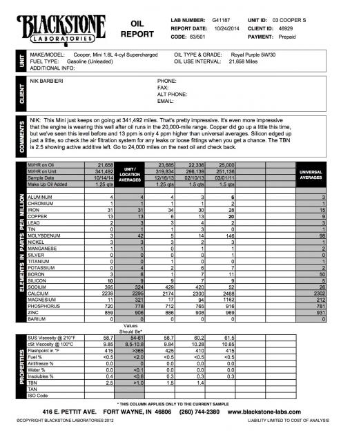

It looks to me like all the things I would be concerned about have been replaced already. There are little things that will likely to fail, like a window regulator or something like that. But with the AC, water pump, and clutch all updated you should be good to go. As for the oil change interval, I wouldn't worry. I run mine from 20,000- 25,0000 with no problems. See latest oil analysis below. Currently I am at over 342,000 miles and still running strong (original clutch too). Get this one and have fun!
Nik

Originally Posted by bavmotors
Xsmini goes 20k miles between changes and has clocked over 300k , but what does he know?
Nothin' Just sharing my experiences. Decided when I got the car in 02 that I would follow the OBC interval to see what would happen. So far, I'm pretty happy, don't have to be under the car changing oil every couple weeks. My analysis reports look good and my compression is still good. So I'll keep my experiment going.
Nik
