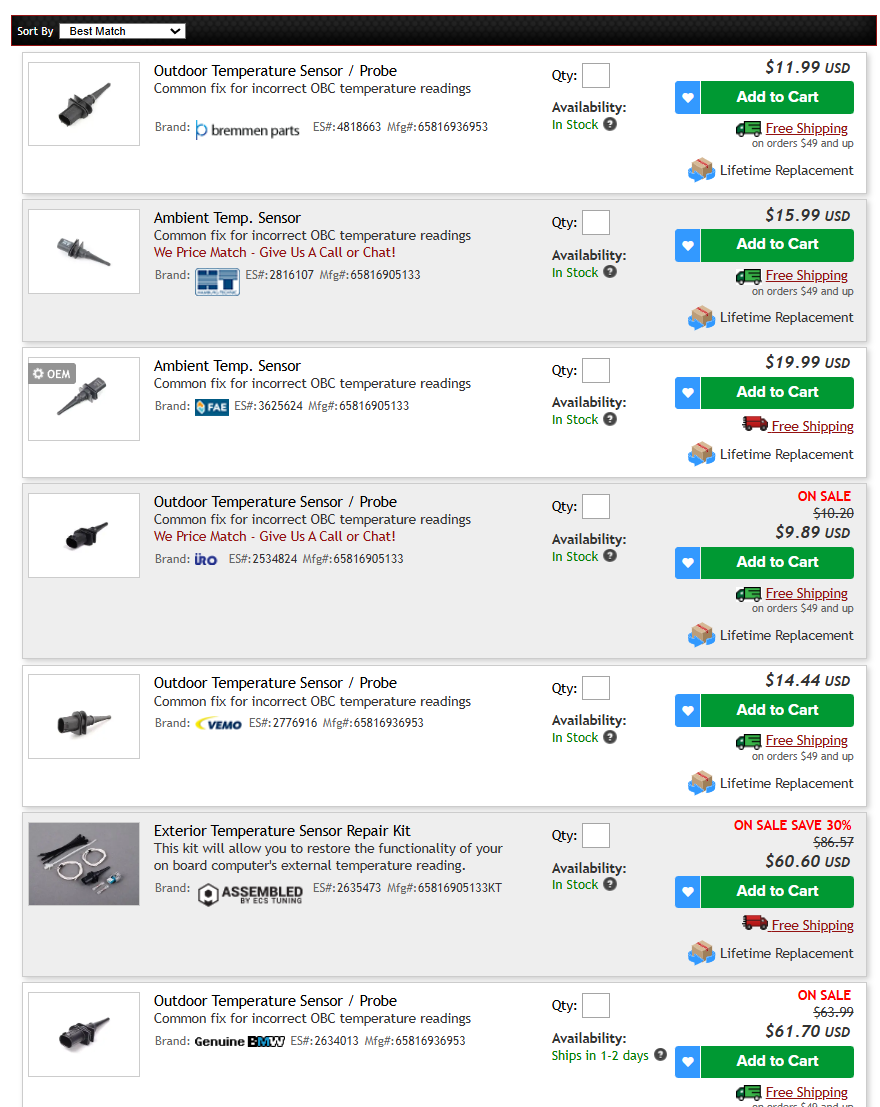

Which one of these are close to MINI in quality?
Old Jun 27, 2025 | 11:21 AM
Posts: 36,758
Likes: 2,548
FAE is the oem for that part. Closet.
