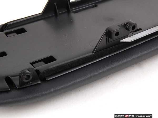

For the factory armrest sliding top : the slider part of the bottom feet can snap and then it will not stay closed.

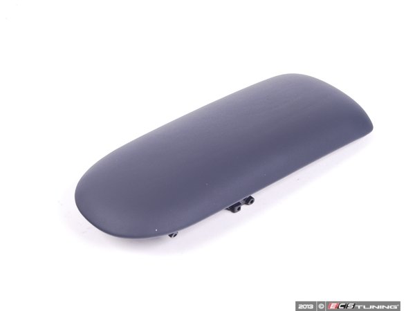

Here are the options for the R50 R53 model, there is leather & Leatherette.
http://www.ecstuning.com/News/MINI_Cooper_Base_S_JCW_R50_R53_Armrest_Lid_2002_20 03_2004_2005_2006/
For the R52 Convertible MINI there was a dark blue leather version also, in addition to the others.
http://www.ecstuning.com/News/MINI_R52_Armrest_Lid_Cooper_S_JCW_Convertible_2005 _2006_2007_2008/

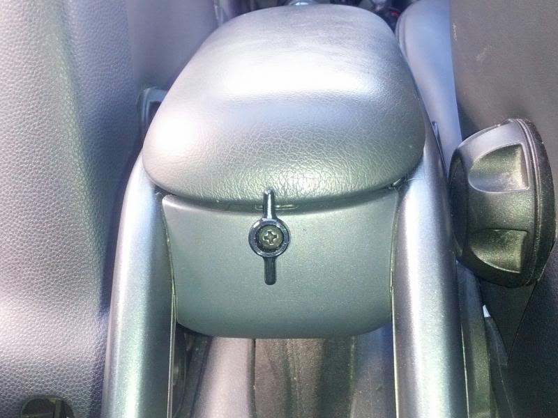

Search for a thread on this with Doug Whalen. Put a wingbolt on the back end of the lower half. Swivel wing up, top stays closed. Swivel the wingnut horizontal to open. Brilliantly simple, <$5.

Check the rails itself. The lid will either have a piece broken off the double feet or at the end where it snaps shut with the pressure. There is felt in the rail also.
Check on that back side on the rails near the on the below picture the left hand side, sometimes those snap.

Looks great. That's my next mini-fix.

I corrected mine using the same type of attachment although instead of the wingnut I cut a flexible plastic tab from clear, flexible tubing. Works pretty well to keep lid closed and does not require twisting a part but not perfect and the length needs to be tuned so it does not stay folded under the armrest when closing the top (it has to snap back up). It is pretty annoying to have the lid constantly slide back open.
