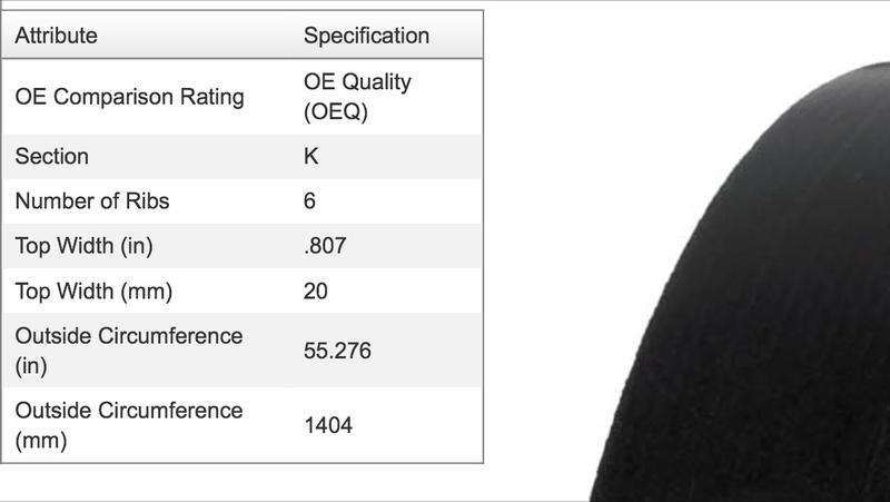

I haven't looked for stretch fit myself. I think key will be to find someone who carries them, and can look them up backwards. I mean if you start by telling them your make/model they won't find the stretch fit.
The dimension of stock belt are in attachment. I think the original was a continental brand. The gates brand equiv. is K060547, K06 13/16 in. x 55 1/4 in.
Let us know if you can track down a stretch fit in that size, or a size smaller for those with reduced sc-pullies, and more important -how does it work on the car.

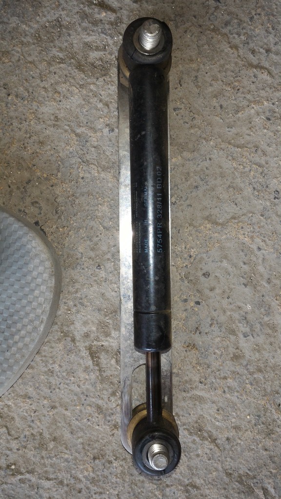

My stock Stabilus damper is limp after just a lil over 5k mi....It's getting a bit tiring.
If anyone has a lead to 6PK1375-1388mm equivalent StretchFit Belt sizes from Contitech, Gates or whomever, please do share...Thanks!
