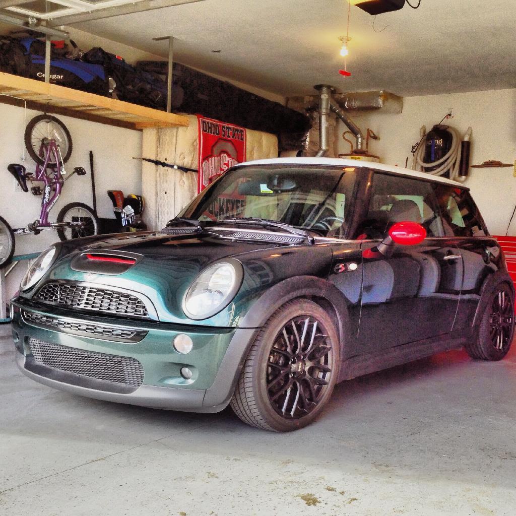

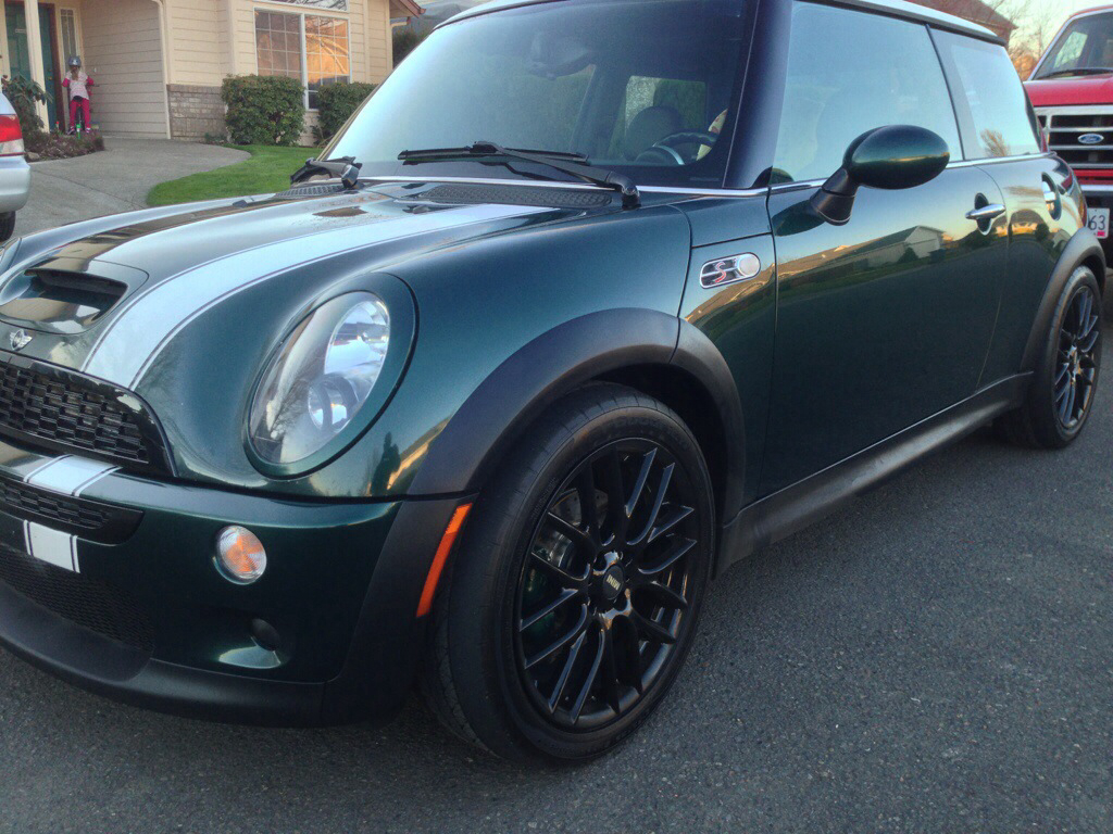

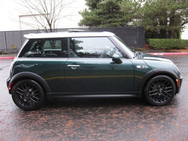

I picked up my BRG 06 R53 last year. This was my first car that I've owned for myself in 3 years. Prior to that, I've been driving a demo car from work. Sure, we have a family car but I didn't drive that daily, my wife does. Anyway, I was searching for a BRG R53 with leather and 3 spoke wheel and cruise control. These are all trivial things but I commuted 80 miles a day at the time so those were some things I placed importance on.
I found my R53 at a local dealer and took it home. It had black leather, cruise, and pano-roof (which I would prefer to not have). The prior owner painted the headlight rings, but that was just starting to peel. He also joey modded the headlamps and painted the mirrors. I looked at the engine when I got home even closer. He installed a Way Motorworks 15% pulley, Dinan airbox, drilled and slotted rotors with new pads front and rear, stripes, JCW Challenge wheels, and the JCW grills. Within a couple weeks, the o-ring for the thermostat failed but the dealer I bought it from was kind enough to pay for the part from Mini and I installed it myself.
How I got it.
I immediately took it to the track for a HPDE with my brother in his 911 C4S and my Dad in his 03 Vette. It did quite well for mostly stock but certain things became evident. The car needed more front camber first and foremost and a little different spring rate in the rear wouldn't hurt either. Also, the control arm bushings were starting to wear on the passenger side. The car also needed real track wheels with R compound tires.

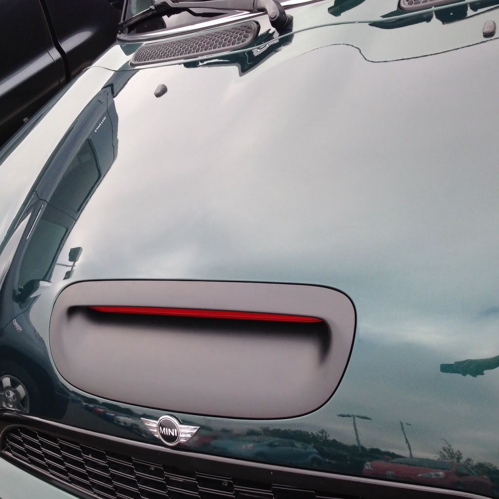

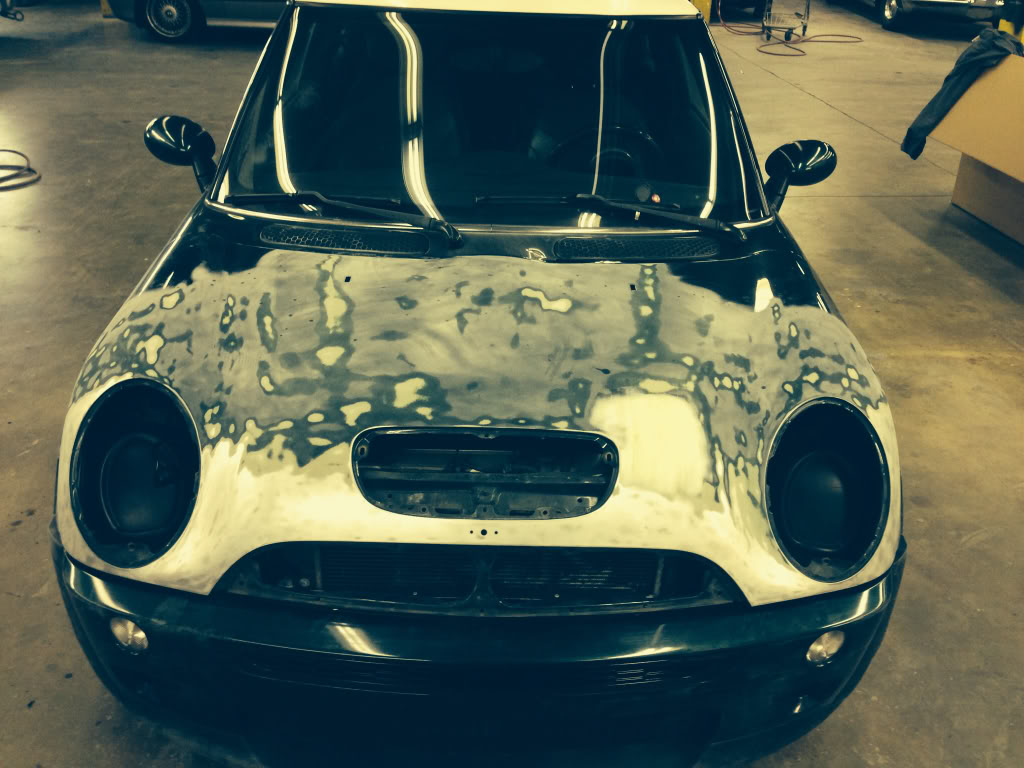

In the meantime, I chose to spray the headlight rings, hood scoop, scuttles, gas door, and rear hatch trim black. I chose to use plasti-dip to see how I would like the look before going to a permanent solution. In the end, I think I will leave the hood scoop plasti-dipped as I like the matte finish - reminds me of a muscle car, and I will paint the scuttles, gas door, and rear hatch trim all black. I am undecided as to whether i will paint the headlight rings black or green but will probably not leave them chrome. Regardless, the headlight rings will be replaced with new ones as they were scuffed to be painted body color by the prior owner.
I pulled off the stripes around the same time. I didn't like them so it was time to go. The paint was faded when the stripes were pulled and some of the clear peeled off when I was removing them. A good friend owns a body shop so off to the shop for some paint lovin.
The end result - glass baby

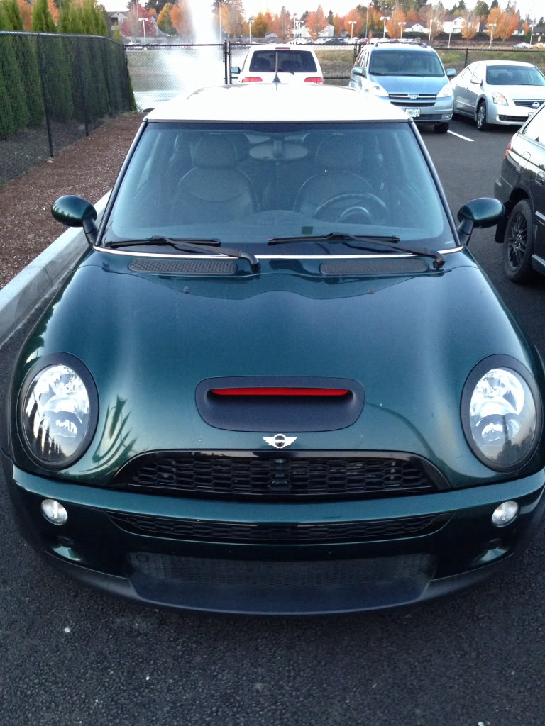

I also decided to do my mirrors in Chili Red. I may leave it, I may not. I'm undecided but the previous owner's refinish of them to body color was not looking so hot.

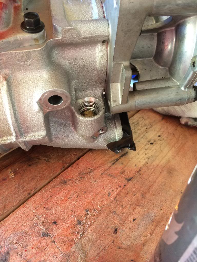

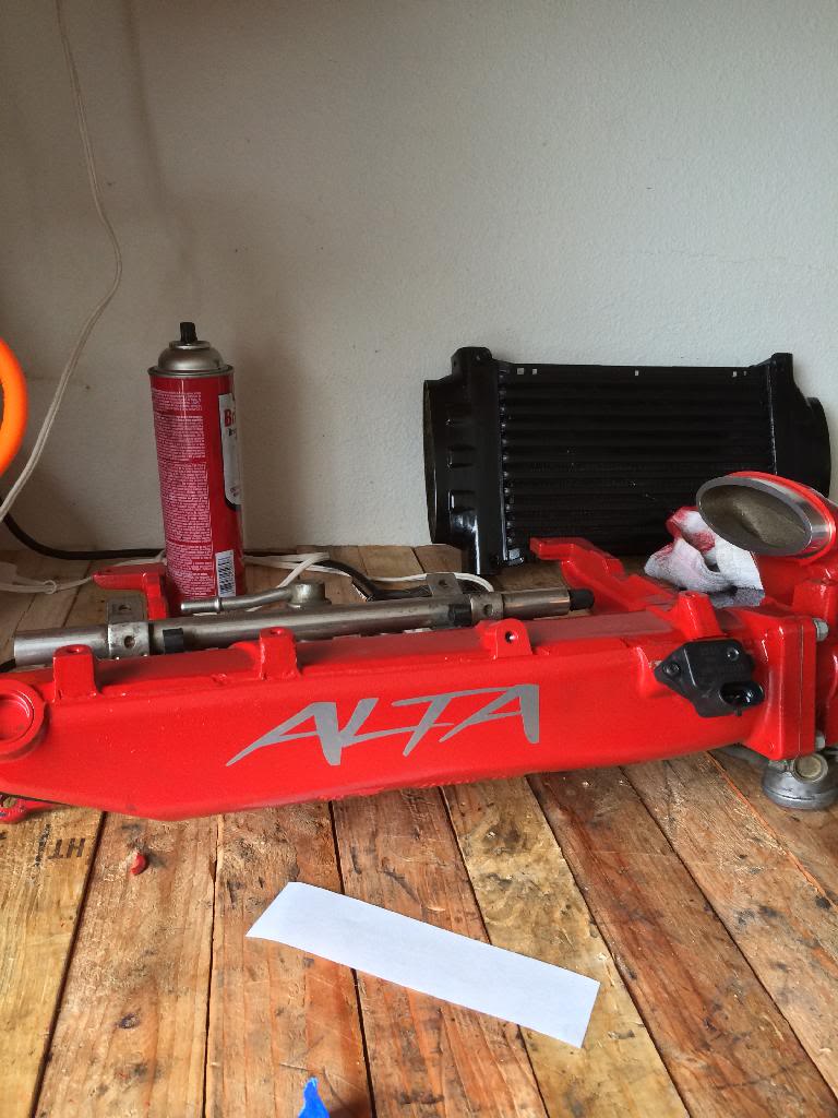

6 weeks ago, the seal for the PTO on the rear of the charger failed sucking supercharger oil in thru the charger and cooler coating my MAP sensor causing it to fail. I yarded off the charger and sent it to be rebuilt. It's taken quite some time but with a main highway closed and a train accident stopping shipping, there isn't much I could do. She's back today though so she should be going back together soon. While she was apart, I installed a new engine mount, M7 catch can, some factory exhaust tips for my soon to be "one-ball" exhaust, ordered the fuel filter, and short shifter. Because of the catch can, i also had the PCV line from the charger blocked off so it's no longer in need.
Blocked off PCV
New Alta 17% instead of the WMW 15%
M7 catch can

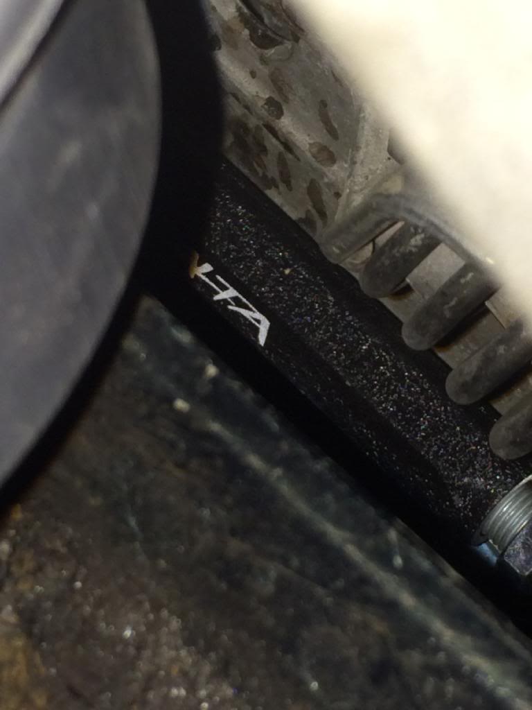

A little spice to the engine bay (I'm sure the Alta sticker and red paint are good for 15whp)
Alta Tensioner adjuster / stop instead of the janky pneumatic thingy with bushings that always fail
Factory tips I got for free. They look a lot better than the ugly stock tips and should work well with my future "one-ball" til I pony up for something better.
I start putting it back together tonight and will post the finished product.

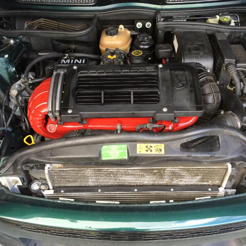

The finished product.

The SC painted horns looks great also.
Old Mar 17, 2014 | 06:50 AM
slomofo's Avatar
slomofo
Joined: Feb 2013
Posts: 58
Thanks!! I figured I would paint everything while apart. A little extra effort.
Old Mar 17, 2014 | 01:01 PM
Posts: 36,762
Likes: 2,551
Welcome, did you paint the IC black also. Little blurry in the pic.
Old Mar 17, 2014 | 02:55 PM
slomofo's Avatar
slomofo
Joined: Feb 2013
Posts: 58
I did. I was on the fence about the possibility of trapping heat but I figured that there are plenty of intercoolers and radiators out there that are painted black so what the heck.

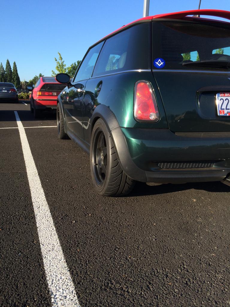

This happened this weekend. This was a test run but I think I want to make it permanent.
On a side note, I need to get this thing lower in the front. Time to fabricate something up.

Black R112 MINI challenge cross spokes on the BRG looks great.
Old May 19, 2014 | 08:18 AM
slomofo's Avatar
slomofo
Joined: Feb 2013
Posts: 58
I agree. I was fortunate enough to buy the car with them. It's one of the best looking factory wheels. I was considering doing them in bronze/gold but I'm on the fence. The red roof is enough for right now.

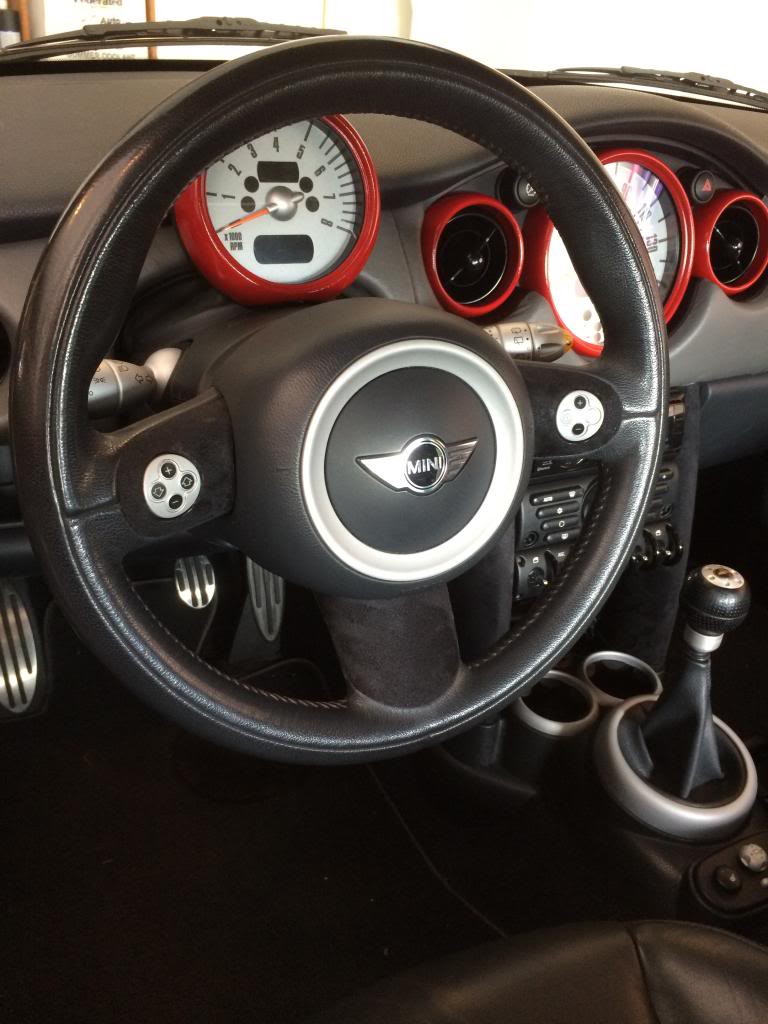

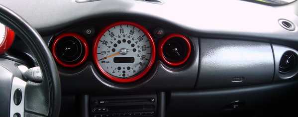

Wrapped the dash in grey vinyl, the down tubes and steering wheel trim in black alcantara, and painted the bezels. Turned out ok. I am considering a brighter red for the bezels. Also deleted the phone buttons from the steering wheel since they are not usable anyway.

Nice. I did my bezels, cup holder rings, shift boot ring & emergency brake handles in Chili Red, which I had the local auto paint supplier mix for me. Dash panels and speaker covers are painted in Rustoleum Hammered Black.
Did u remove the steering wheel trim, or do it with them attached?

I removed the 3 pieces of trim and did them off the wheel and then installed them. worked out really well.
The dash has since started peeling because of the adhesive I used. It can't handle the hot weather so I will be redoing it yet again.

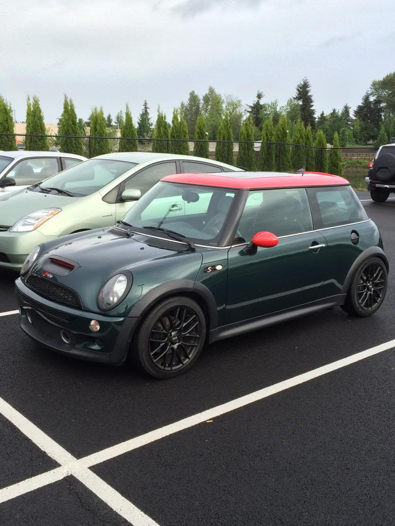

I stripped the plasti-dip off the other day. I'm diggin the look but I'm also missing the Challenge Spokes.
