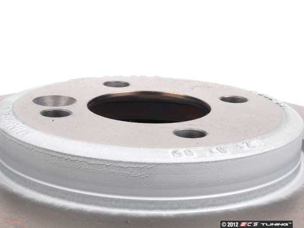

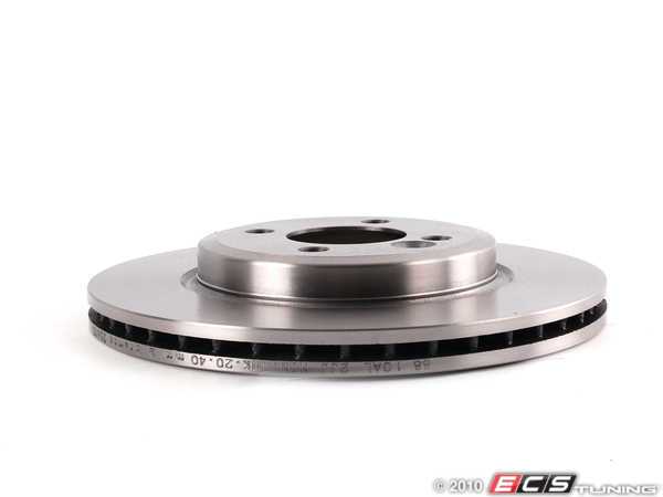

Some times its casted into the rotor hat, on OEM MINI rotors think its on the bevel need the wheel mount.
2004 MINI Cooper S
http://www.ecstuning.com/Mini-2004-Cooper-R53-S-Coupe-L4_1.6L_W11B16A/Braking/Rotors/
On outer is one the edge:

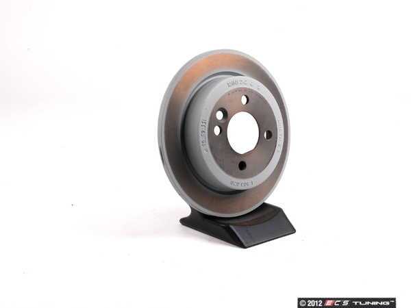

2004 MINI Cooper S Rear:
http://www.ecstuning.com/Mini-2004-Cooper-R53-S-Coupe-L4_1.6L_W11B16A/Braking/Rotors/2
Think the spec are 20.4 fronts and 8.4mm rear for Non JCW. Stock.

I can't help you with reading those particular micrometers but like ECS said, it's stamped either on the edge or on the rotor hat. It will say "MIN TH. 20.4" or something like that for the front and probably 8.4 as well for the rears. When I checked my fronts, I did it the poor man way with a regular set of digital calipers (not the outside ones you're supposed to use with rotors) but I took 2 coins and stacked them putting one on each rotor face as to not measure the lip. I then measured them off the rotor and subtracted the difference and confirmed that mine will need replacing on my next brake job. Not perfect, but close. With yours make sure you measure in a few different spots if possible and on both the outside and inside edges.

Looks like I have plenty of rotor left and also plenty of pad thickness. With over 80K I thought I would be close to needing new pads and rotors. The difference between the lip and the face of the rotor is very small.
I don't see how people can miss the 'min. 20.4 thickness' stamping on this particular year rotors.
