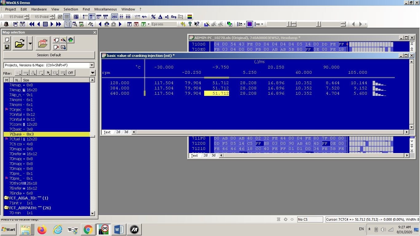

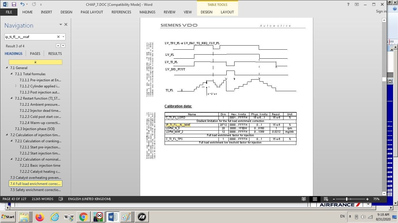

I have been studying Siemens EMS2000 DME for almost 10 years.I did it as a hobby.When I first opened the Bytetronik sw ,I thought, that's it the GOD of tuning sw.Big mistake.When I looked deeper I realized that it contains many mistakes,maps wrong names, wrong maps axix, wrong units for maps and axis and so on.I will give some examples.
1.Full load fuel map.
Bytotronik map.
Real fuel map
Siemens docs describe this map very correctly.
2.Crancking injection map.
Bytetronik map.
Real crancking injection map
My conclusion was that using Bytetronik is not the best way to tune Mini R53.Best way is to use Winols editor from EVC and a damos file(original mappack of Siemens EMS200).
