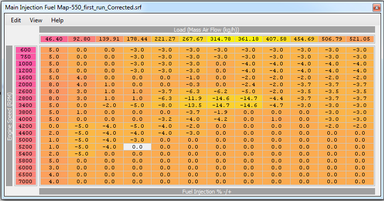

Im not saying dont purchase this, or its hard to use. The software is great for tuning a mini. Its just that the mini ecu is very different from any other that I have seen. I have used the megasquirt on a two stoke racebike that had been converted to FI, and it worked great. The mini is like a three legged stool in the fact that each table relies on others to perform its job.
Attached is a list of some of the adjustments in the software and what the MAIN FUEL MAP looks like. If there were a version of the software that worked like megasquirt it would be just like any other tuning software. I like the fact that its not.
Im not 100% sure, but I think DG took his cooper to a very knowledgeable tuner, but had never done a mini. Im sure if you search around you will find his story.
Mynes service is very good and the FA will give you more control than you will need. Im not building my car into a racecar, I am just doing some bolt on stuff.

I'm surprised you left the hole in the center of the map Hillis, getting that evened out makes things a little smoother for the daily drive...

lol, so much has changed since this map. I could feel the hole.

Wow, it definitely looks more complicated than it needs to be. Too bad there isn't any more software options out there.....
It's learnable, but they sure make it more complicated than it ever needs to be. What software are the "pros" using? Are they all using Bytetronik? There has to be something more user friendly out there.....
As far as the Bytetronik....do they at least give you a detailed manual telling what all of the different maps and functions do.....or are you on your own? I guess they have their tech forums...too bad you can't even access them unless you pay for their product.

IQ I'm no pro, but I don't think it's the software. The mini/bmw ecu is complicated and they built the software around the ecu. BMW is the complicated part.
This software will tell you more about the car than you know. First thing I did was adjust my idle and the traction control sensitivity.
