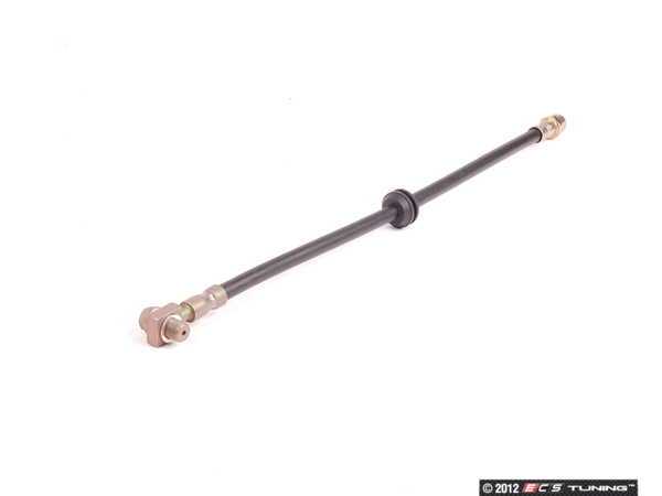

Buy a stock new rear line, which comes with the bolt. It also comes with thw gasket rings.
Brake Hose - Rear For MINIs up to 4/2003 production.

If you are looking for SS lines for pre 4/2003 MINIs, we have them here. Just reuse the banjo bolts.
ECS Exact-Fit Stainless Steel Brake Lines - Kit up to 4/2003.
