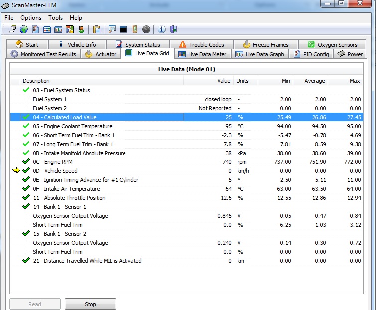

Changed plug and wire, scanned OBD O2 sensor seems good
I do see a black tail pipe
What else could cause tHis?

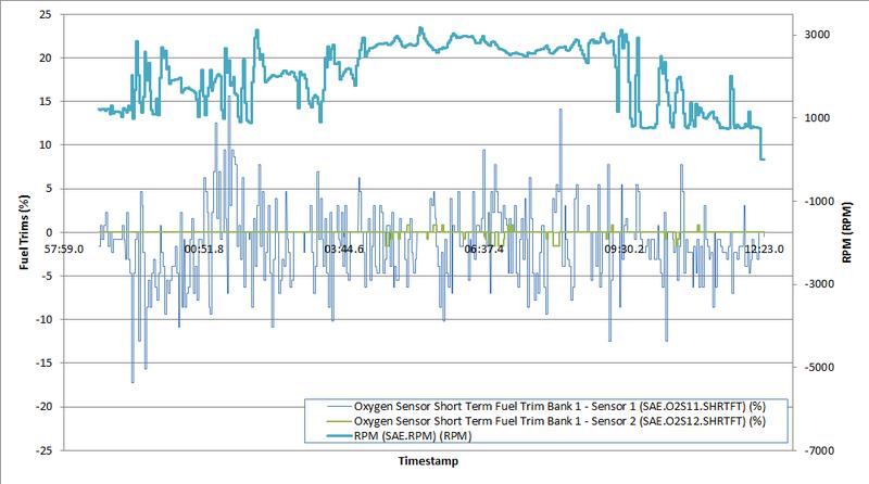

The fuel trims will tell you a lot. There is nothing more powerful to understand than how to read and understand fuel trims.
Read them.....there are short term and long term.
The short term will fluctuate. And can go high....and lower than normal
It is the long term you need to be looking at. The long term is important.
The short term makes the long term. Long term is the average of many short terms.
Rich is -10 to 0
Lean is 0 to +10
When trims reach +5 car is starting to run too lean.
Stoic his 0 and is a perfect engine. Very rare to see 0
The computer sees lean mixture...it tries to add fuel.
If the computer is reading wrong...........it is adding fuel to air that doesn't exist. The positive fuel trims mean the car is running lean. The rich mixture and low mileage is probably from a lean mixture. Not a rich one.

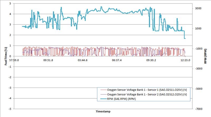

It doesn't matter......o2 should be read anyway after 100k. It is a consumable sensor. After 100k the are said to be replaced as preventative maintenance. They wear out.
There are 2 of them. One before the cat. One after the cat.
The one before is the primary. It helps control fuel along with the maf sensor.
1 of the 2 main important sensors.
The second sensor after the cat. Tells the computer that the first sensor is working. It should not run between .1and .8 only the first one.
There are variations.....you just don't want consistent .3 to .6 or .1 to .4
Stuff like that. At idle at high rpm. They should always behave the same.

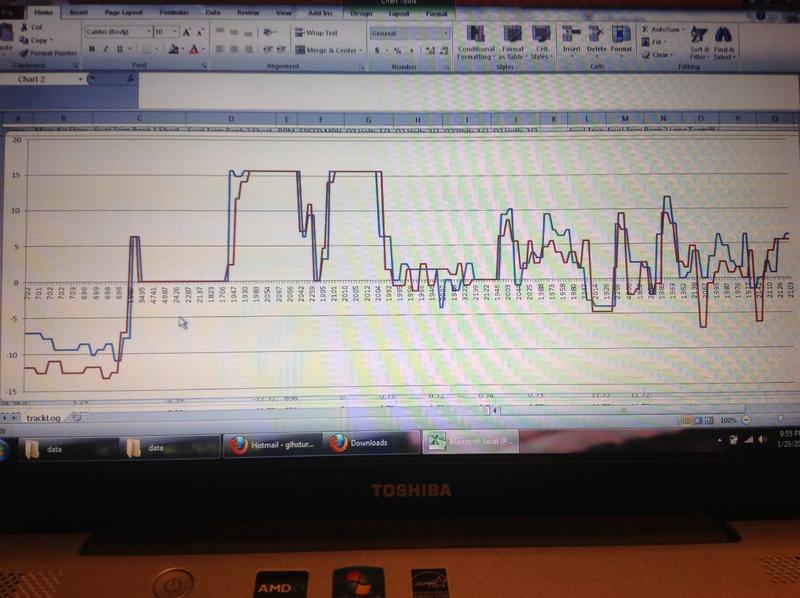

My fuel trims were +10. After much graphing and comparing with another car. We found maf sensor to be slightly off. Just slightly. We found it to be low quality Chinese knock off. This reduced mileage. I replaced the sensor and now run at 3

Sensor 2 doesn't bounce. It should be consistent. It only tells the computer the cat is working .....it shows after catalyzed air fuel ratio.
If all the fuel is catalyzed properly. It shouldn't really ever move much

Actually sensor 2 does move quite a bit, is that indicate the catalyst is not working properly?
And also the load value seems high, any thoughts

Hoping someone on this thread can provide some help to me. Short story, getting bad MPG (~16). Car does fine on the highway (~30mpg) but pulling away from a stop drops fuel economy dramatically.
I've output the relevant data from DashCommand - my car appears to be running lean. My long-term trims also show the most variation while I'm at idle/neutral....
Which fuel trim sensor should be my reference point? Sensor 3 suggests I am running very lean.
What can I do to diagnose this further?
Anyone tried a MAF cleaning on a R53? (I know, I know, they are MAP/TMAP sensors, but people have suggested cleaning improves the situation).
Just at a bit of a loss what my next steps should be....
Sounds like a vacuum leak. That would affect it mostly at idle. Check vacuum at idle......I'm thinking at least 18 to 20psi....buy or rent a vacuum gauge. Also....make sure thermostat is still good and staying where it needs to be. They are electrical and wear over time.
What is sensor3? 4 cylinders should have bank 1 sensor 1 pre cat.....and bank 1 sensor 2 post cat
6 cylinders have split exhaust manifolds.......bank 1 sensor 1..... Bank 1 sensor 2 post cAt first 3 cylinders
Bank 2 sensor 1.... Bank 2 sensor 2 second 3 cylinders or cylinders 4 5 6
You car should have no sensor 3 unless it's back by a secondary catalytic converter.....
So check LTFT bank 1 sensor 1 and 2
Check your o2 sensor voltages. To find out if maf is working correctly you need the specs at idle.
