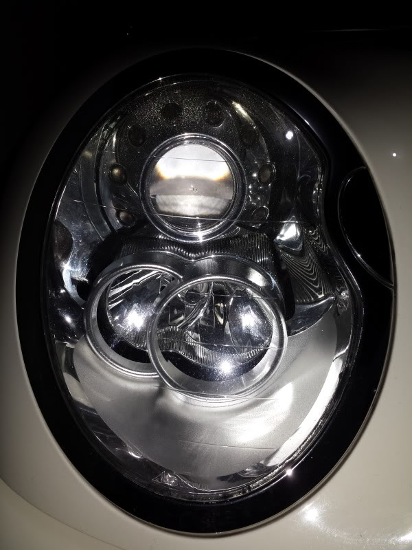

My car came with stock D1S reflector hids, and auto levelers. I upgraded them to the newer style projector lights but their d2s projectors SUCKED, so after about 20 emails back and forth with Matt (TRS) we got set on Mini H1's. Here are some pictures more to follow with my good camera.
-B
All done
Stock mini e46 projector vs Mini H1 Bixenon
Mounted to stock bracket with some sheet metal
mock up with shroud
light up at night

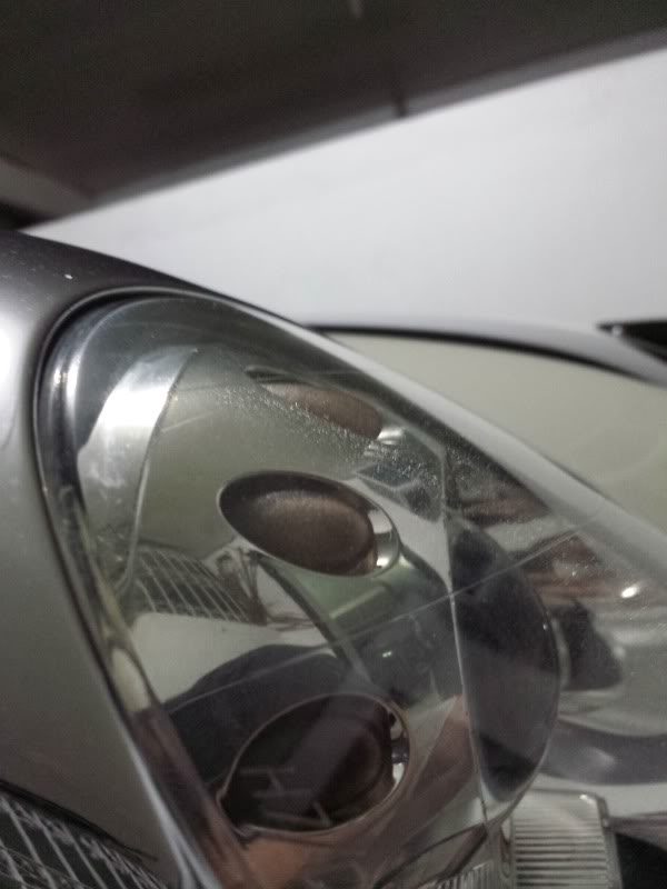

oh i see. but the gen3 hella ballast may not fit the stock connector of my 05-06 projector hid headlights right? currenly im using gen5 matsu but it is mounted on the bottom(outside)part of the headlight. i think it will get wet. I'm thinking of just putting an ordinary ballast so it is waterproof hehe...
have to trim lots of part hehe... in addition, i used epoxy and brackets to mount that projector.

i'd go with hella ballasts, or the morimoto ones from TRS. did you test to make sure the highbeam and the low beam line up properly since they are single xenon? also did you measure the forward distance from the lens to the stock bracket? if you notice when put together, the stock projector only sits about 1/2" from the inside of the headlight lens. So if you are anything past that, the shroud and/or the projector lens will rub.
Old Sep 18, 2013 | 06:05 AM
scoopy's Avatar
scoopy
Posts: 395

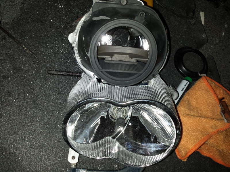

we just finished one headlight we will continue tomorrow for the other. it was really tight. i'm not sure if the shroud is touching slightly the lens. but i'm sure the projector doesn't touch the headlight lens.
Old Sep 18, 2013 | 06:07 AM
scoopy's Avatar
scoopy
Posts: 395
we trim the shroud so that it can move closer to the lens. will take a pic now
