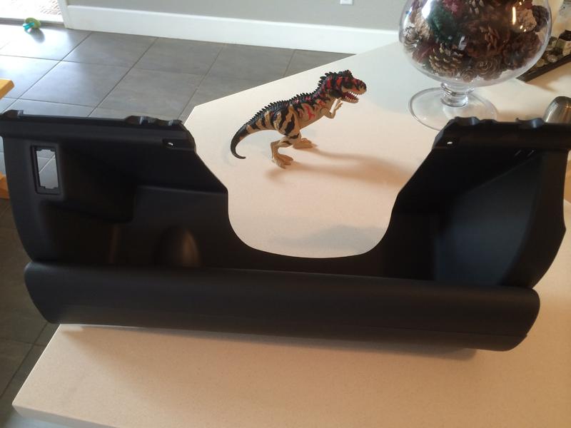

The euro parcel shelf
There is no room in a mini to put stuff, Things like your wallet, house keys, the usual everyday odd's and end's you need. But, are uncomfortable in your pockets while driving.. last week, buddy took me for a spin in his R53, as i was perusing the interior of his mini, i saw he had a shelf under the steering column. "The euro parcel shelf" he told me "Really hard to find" he said. Turns out they're not. Out Motoring "Had" 17 in stock, now, i have one of those..And a place to put all my junk. besides, the center console bucket which isn't conducive for DD. Comes with the switch cover, mounting screws and a bottom liner.

Whats with the T-Rex???
It's funny, until you mentioned it. I hadn't noticed it. now, thats all i can see ")

I thought it was to give us a scale for the parcel shelf.

OMG!! It's perfectly placed.. I can't delete the Pic :-(

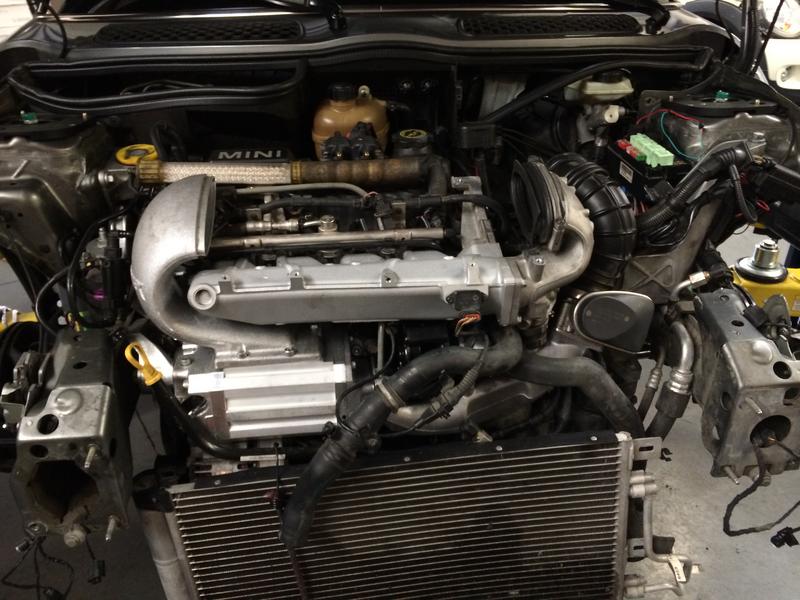

I'll be done today
Where I got to last night… IM is on, Injectors are in, subframe today, radiator and the bumper carrier, fender and wheel wells.. I'm driving again..
it's been two weeks since i've driven my car..can't wait..

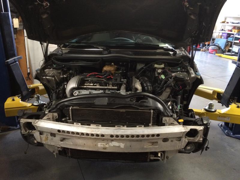

Well not quite as much done as i expected today, i helped put another clutch in (Third clutch in two weeks. Now i know how to change the clutch on a 1st gen mini in my sleep )
Anyway tomorrow, all i have to do is put the bumper and intercooler on, flash it for the 550's..
Swapping out the gear change cables made a huge difference to the "feel" of the tranny!! the old ones were full of crud...
