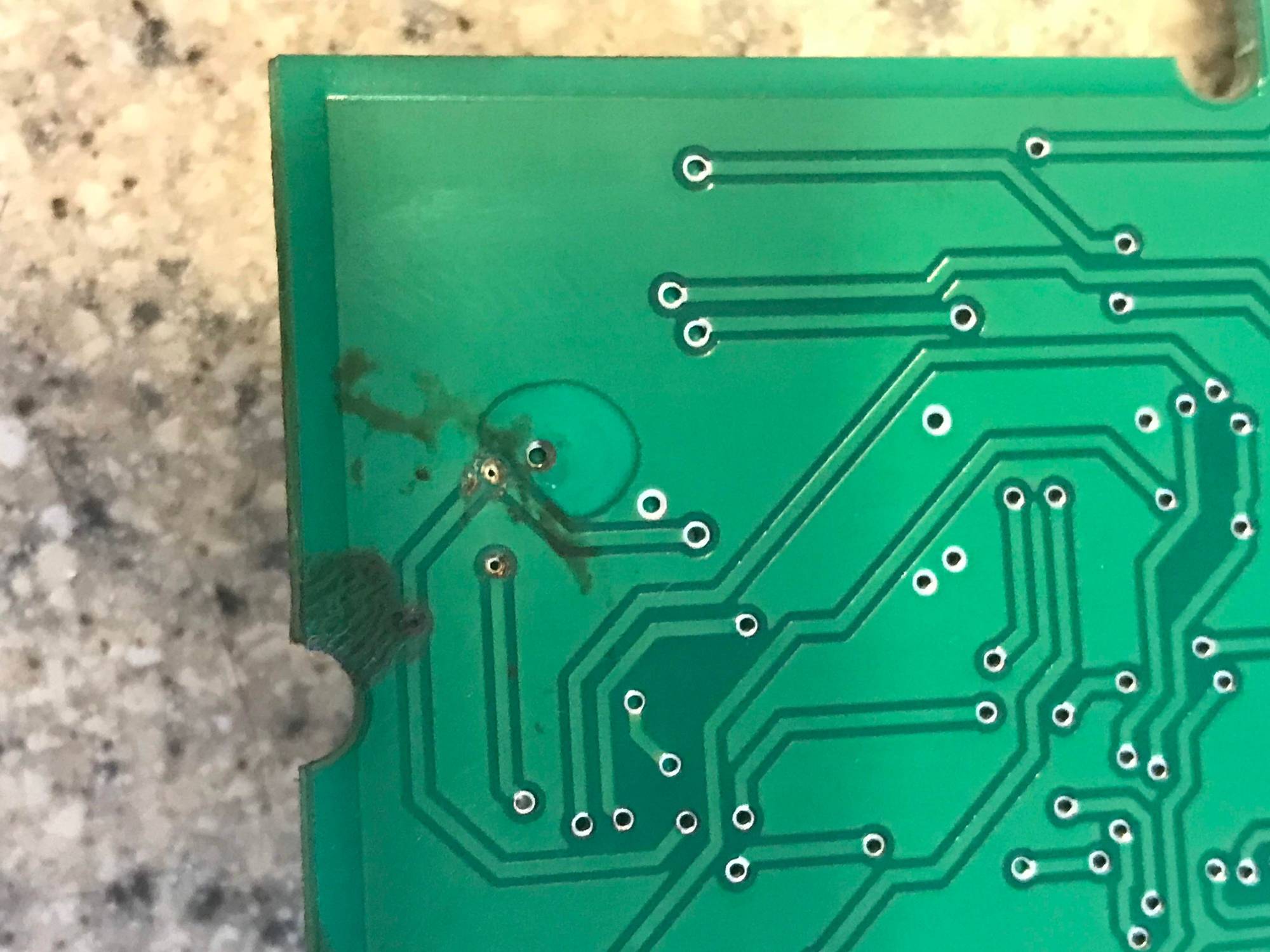

Tore apart the center console, unplugged everything, (lighter, leds, mirror switches, the actual switch to gear input) and running this way no difference to the car, so as it was too hot to work outside anyway I was looking for wiring diagrams and found the motherload free factory documents for my car.
http://www.bmw-planet.com/2011/11/05...cal-documents/
While looking at the wiring documentation for the CVT, you see something strange you can't really guess looking at a bunch of plastic "Modules" especially if you don't think about the car working on a bus system. There is one communication line (Green + Yellow) used throughout the tranny communication circuit and one ground so since the switch made no difference in any of this, it was (probably) bound to be one of those that was the issue. Pulled the switch of the shifter and found what is inevitable (in between three cup holders that aren't waterproof) in the Mini, a switch corroded by spilled drinks.
Cleaned off the switch and sanded some of the blistered soldermask and found a single burned off trace:
This was on the Red wire on the harness for the switch, which was the Green + Yellow line in the GIU/ECU harness. It was burned off up to the via, so I just jumpered it with a small piece of 30 AWG kynar wire like this:
and, long story made a bit less long, this fixed all of the above codes, switch was able to communicate, no more break in the serial communication to the transmission, no more plausibility issues with the speed sensor. As far as I can see there is only one part regarded by the car as PRNDL input. it is the switch on the side of the selector lever.
I thought about just replacing the whole switch because the fix seemed a little kludgey but after trying to buy the switch and being told that I need to buy the shifter assembly for $500 I don't think I will. Price for the repair went from $6500 to $500 to $0.01 and I'm really alright with that. I'm only posting this so that other people don't waste time like I did.

What circuit board is that in the OP's photos? I think I have the same issue but I can't figure out what switch OP is talking about...

Anyway thanks for the reply. I found the circuit board OP was referring to. Sure enough, it had liquid residue on it, and there was no continuity between the 2 points OP jumped. I tried soldering a line just like OP, and it resolved issues for a drive around the block. After putting it all back together, EP mode is back!
I'm convinced the board may be fried in other areas. Will purchase a new 2nd hand shifter unit and see. Does anyone know what the board actually does?

I've taken the shift sensor off and looked at the circuit described above but that looks fine. BTW, it mounts alongside the shifter against a spring loaded magnet on the shift shaft. I've also removed the TCU (transmission Control Unit) mounted on the brake pedal frame. That also looks perfect.

Hi everybody, I am new around here but basically I have the exact same problem (P0705 error, EP on dashboard and tranny not going over 10 mph).
I removed the module next to the shift lever and bingo, it was burned on the same exact spot as the original post. Same cause, spilled coffee. For those who are wondering where it is, its on the left side of the shifter, only 2 screws hold it. Part numbers reads LEM 400460061787-10 on my 08 R50 CVT
Cleaned and took it to soldering as suggested, put it back, cleared the P0705 error with and OBD scanner and test it. It worked for less than a minute and the EP mode came back again :(
My mini only shows EP on the dash and does not change when shifting P-R-N-D or on the sport mode.
I want to think that the module is burned or dirty on some other spot I did not detected, same case as jmai86.

I purchased a 2006 R52 that has CVT transmission problems. The trans is in good shape. I have pulled the pan and very little metal in there. The trans will not shift out of low. I have put it in learn mode and cleared the adaptations. I did the low gear learning, but every time I try to do the high gear learning (road), it will not kick into high to get me to 55 mph. I put my OBD reader on it, and I get a P1611 error. I saw this thread on it, so decided to pull the circuit board and have a look. The photos of the extraction and findings are attached. The bottom line, there definitely is some arching that happened with the board because of something leaking down into it, but I dont have the same problem as the others. Mine looks like it might have shorted one of the transistors on the board. I have ordered a replacement shifter, which has the board on it. Thats cheaper than trying to buy the part from Mini ($40 v.s. $788). I will keep you posted on how it goes. I think that to start out, I will remove the board from the new shifter and put it on the one thats already in the car.
Didnt have to remove this. Since I didnt know where the board was located, I did.
The board is the black piece with the white sticker in the middle of the picture.
You can see that something wasted. That big round spot is where the board was arching and heating up.
