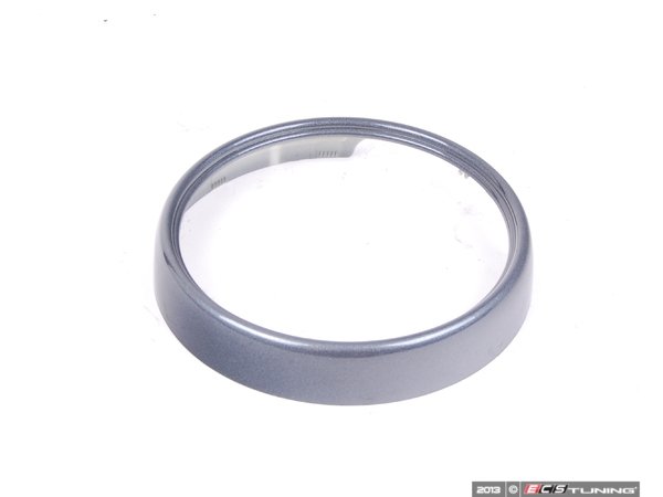

#5 in the diagram just clips out and then you have the .
Example of the Anthracite Trim Ring part number 51457059168 , the other trim rings ( chrome for your ) are the same shape for the standard center speedo, they just have a different finish.
http://www.ecstuning.com/Search/SiteSearch/51457059168/ES117314/

Trim ring can clip off. Just like in the pics.

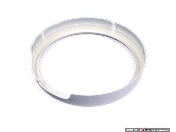

You can order the cluster as a replacement "chrono pack" speedo. Part number 62109126997 , is brand new non coded, and then It will need coded at a MINI dealership to your vehicle.
You can pop the trim off, just when prying it back as you can see the gray trim surround has tab placed around the interior sides. Try working around under the trim.
Here is the back of the trim.
