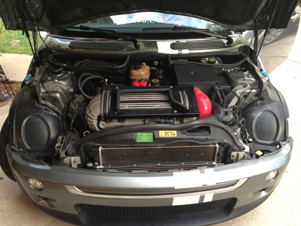

First Issue: P0222 Lightly Modded
Whats up guys & gals. First post here other than the intro thread.
Bought my first MINI about 4 months ago and have loved every minute of it. I used to be in the vw/audi scene so I'm no newbie other than to this engine itself. I started modding the moment the car hit my driveway.
Listed here:
Alta 15% pulley, Alta CAI w/ tube, Alta IC diverter, magencor wires, msd coil, brisk colder plugs, catch can and just recently performance header & race cat.
Now on to the troubles, my serp belt snapped leaving me stranded about 2 months ish ago. I decided that would be a good time to upgrade the pulley and ignition. Upgraded to the previously stated kit and everything went great. I had a small idle issue following that. Never effected drivability until now.
Installed the header / cat combo an the problem is now more pronounced. I do believe the headers have any correlations other than it being louder. I took to autozone and got the codes pulled and they were both for the throttle body P0222 and one other.
Pulled the TB apart and cleaned it. It was pretty dirty but I feel like it is the TPS, which would have to replace with a new TB.
Before I go off and order a new TB I want to be sure that is the problem.
Anyone have any suggestions on what I could test or what I could do?
TIA
For the record, I have been "searching" for days now

The Bay
