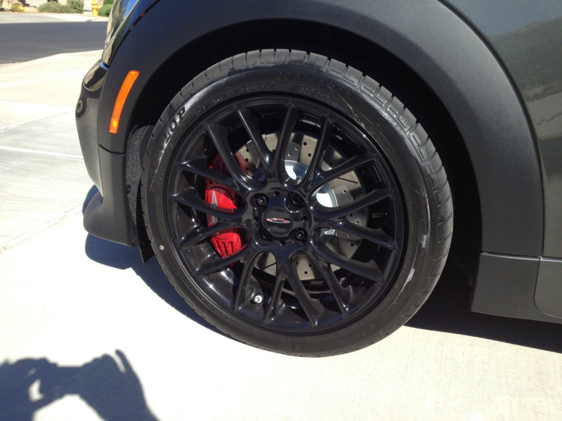

Slotted and drilled are an option as I have them. Sorry, I quoted you
