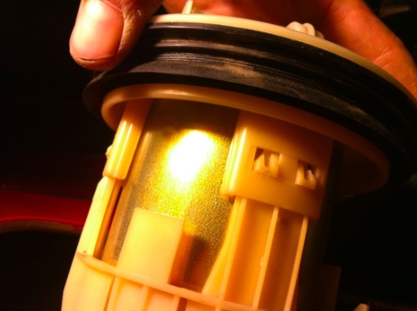

Hi
Wanted to replace the fuel filter in Mini One R50 2002.
Got the new filter , and wanted to work according to this guide :
Mini Cooper S (R50/53): Replacing Fuel Filter
http://www.billswebspace.com/MiniR50...erDIYGuide.htm
when pulled the filter, found out that it's not the same as mentioned in the manuals.
it looks different ! couldn't figure how to separate it from it's housing.
how can i dis-assemble it? the metal round thing , is it the filter itself or it's housing ? i ask cause the new replacement filter i got is paper made.

Ive never seen that as a filter... you didn't pull the fuel pump out did you? What side did you pull this off of? Driver or passenger?
Old Jun 5, 2013 | 08:33 PM
omri617's Avatar
omri617
Joined: Jul 2012
Posts: 40
From: Israel
Passenger side
That is the fuel pump , with the fuel level thing attached to it too
The filter is located inside the fuel pump, isn't it ?

You took the wrong side off... the fuel filter canister is on the passenger side cover...which is next to your fuel pump that you already have taken out.. Just pull off the inspection cover on the passenger side.. you will see then... If you have more questions feel free to ask... But now you have to put your fuel pump back in... Good luck

Done more search and found this post :
Heres a previous post, same problem as you
DIY R50 Cooper Fuel filter/sender problems
Hi all, im hoping you can help me with a problem i have.
Yesterday i serviced my R50 cooper 2001, when it came to the fuel filter i looked in the manual to find it is in the tank etc.
When i pulled the sender unit out i found it looks different to the one in the manual, and every one ive seen on the how to's online, most seem to simply have a screw top and a paper filter, which is what i was supplied with, however my sender has clips that you need a million hands to hold and pull the top off! and a metal filter which i cant seem to remove once the top is off!
What i want to know is why is my sender different to everything else ive seen.
Any help would be much appreciated!
Many thanks
Gareth
Old Jun 5, 2013 | 09:01 PM
omri617's Avatar
omri617
Joined: Jul 2012
Posts: 40
From: Israel
Thanks Nun. For the sake of future users , here is the rest of the short , important thread:
Here i am with the same issue, just ordered the filter etc, cracked open the tank and there before me sat something not covered anywhere on the net, and looking nothing like any write-up I've seen, well up to the point where it states to twist open the housing and instead there are clips and looks to be a metal canister inside.
Very glad i saw your post as it saved me trying to undo the numerous clips to find that metal canister, big thumbs up for that ;o) saved me so much hassle and swearing.
Did you find out the solution, as i would be grateful to know the answer to this puzzle
Alan
So...................
MINI Coopers (non S) built prior to 03/2002 have a steel filter that is not normally replaceable, you have to replace the complete unit if you think its giving problems.
MINI thereon had replaceable paper filters
WTF...

I honestly can say you are the first that ive seen to have this.. Ive done several of these filter changes and never came across the type you have.. Sorry but I don't have any info on that one!! Good luck though..lol

I wanted to share a thought :
How about changing the fuel pump for the later on models? Is it possible ?
In this case , filter can be replaced .
Part # 16146766176
http://www.ebay.com/itm/16146766176-Mini-Cooper-Electric-Fuel-Pump-R50-R52-NEW-VDO-OEM-/120940267781?pt=Motors_Car_Truck_Parts_Accessories&hash=item1c289a0905&vxp=mtr?
