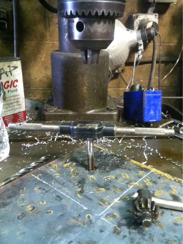

In the process of making my own puller out of 5/8 steel plate with a 3/8 hole for the puller. Not sure what to use as a stop to prevent damage to the crank threads. Any ideas?

So yeah...just waiting on Fluid pulley to come in now.

Yeah...looks like you found the issue!!
Congrats on getting it off.
