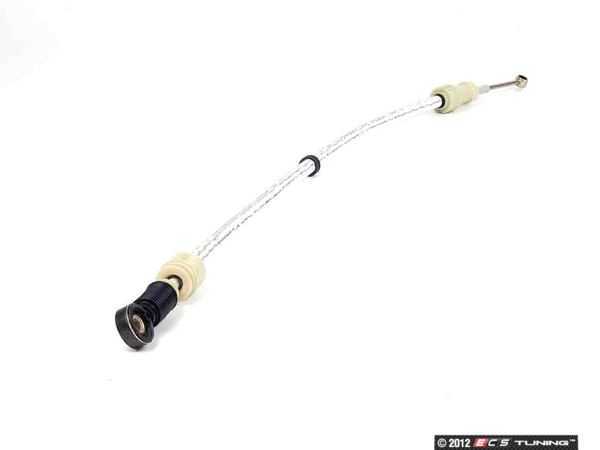

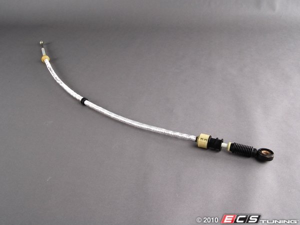

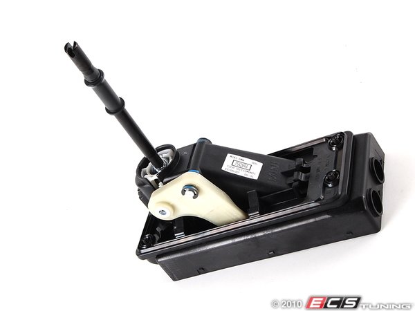

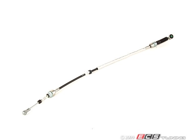

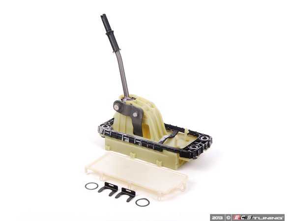

+1 on the cables. They can pop off from the front above the transmission.
Make sure you get the right cables there is Condition A and Condition B shifter lugs. Up to 1/2004 production. You can see in the diagram condition A and B shifter base.
Check the shifter base also, something might be disconnected there or damaged.
Gear shift lug condition A - Manual
http://www.ecstuning.com/Search/SiteSearch/25117518850/ES47188/
Shifting Cable Selector Shaft condition A -1/2004
http://www.ecstuning.com/Search/SiteSearch/25117531707/ES47285/
Shifting cable selector shaft A and B. -1/2004
http://www.ecstuning.com/Search/SiteSearch/25117531708/ES47286/
Gear Shift Lug Condition B
http://www.ecstuning.com/Search/SiteSearch/25117542693/ES47324/
Shifting Cable Selector Shaft - Condition B -1/2004
http://www.ecstuning.com/Search/SiteSearch/25117547371/ES47343/
You will need the shared A & B part again.
You can match them up to the old ones and have the correct part. You can determine the condition A or B dependent on the comparison of the shifter base lug.
