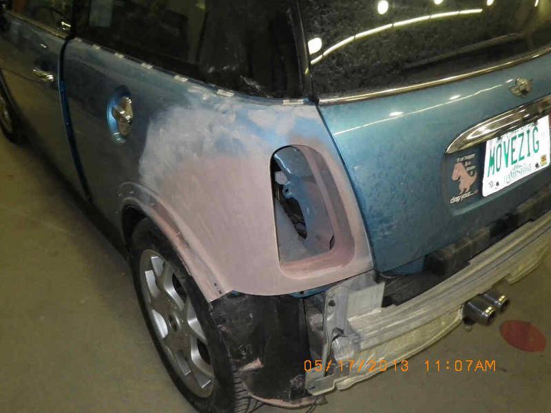

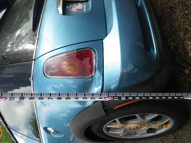

My car went off to the shop with about $3k in damage. It's had a tire replaced, a wheel refinished, a new bumper, new tail lamp assembly, quarter panel repaired, and some paint work and should be ready for me this week. (I've included a couple of photos from the insurance adjuster).
I'm a little concerned about what to look for when I pick it up from the body shop. I assume that I should bring it to my mechanic to have it double-checked for function and safety, and obviously I won't take it back if the repair doesn't look good. What else should I be looking for?

Diminished value is a grey area in Mass, so I cant help you there as its technically not recognized here.
By the looks of it they didn't blend the gate so you may have a color discrepancy there.
Be sure to look at it form EVERY angle in the day, in the night, in the dusk and the dawn. make sure it matches! MAKE SURE the qtr panel matches the gate and the lt door.
Check around the gas filler for tape lines/ overspray.
Check the jambs @ the door jamb and the gate jamb.
There should be no hard lines masked off there.
Check the glass for overspray.
Make sure the flares are secure as is the bumper.
Muke sure the bumper fits as it's supposed to.
Check for dirt bumps or dust in the paint finish.
Check for consistancy in the paint finish (orange peel, sags etc), make sure its the same all across the panel. Its normal to have some "texture" in the paint
Make sure your light fits properly with even flushness and spacing all around
Make sure the all the bulbs in the lamp work
They are gonna blend that color forward into the qtr panel and clear coat the whole panel. MAKE SURE YOU CANT SEE THE TRANSITION of the color going forward especially around the fuel filler as they will most likely use that to help aid disguising the blend.
They're choice in primer color confuses me but whatever, I dont know what paint line they are using. Should be fine.
These are all items (plus more) on our qc sheet + like 100 more items.. lol
Our shop has a QC process that lasts upto an hour at the end of every job we do.
Hit me up with any questions you have about it. I've been in the collision business for over 15 years on both the shop and insurance side.
Good luck!

Still say bring it back to shop. Can't see ur tranny being related to the accident though... the exhaust maybe but it doesn't look like it was hit from ur pix. Was the car towed? Maybe tow truck damage
It was towed at least three times after the accident, so it's possible that it was a towing-related problem.
