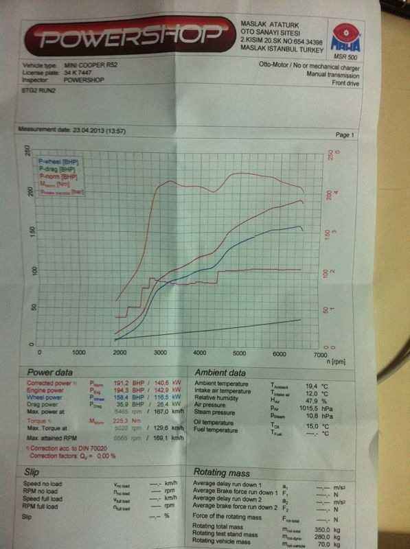

hello everyone. I have a 2006 cooper s r52 automatic. I have milltek header and full exhaust system, alta 17 pulley, jcw gp intercooler, jcw air filter without flap and tune. my problem is my boost is too low under 4500 rpm and my dyno graph shows that. after 4500 rpm all my power came alive and the magic happens but under this rpm it is very boring to drive in trafic. any one knows about this issue? Btw, I have changed my bypass valve but it is not the problem. If you look at the attachments you will see the jump in the boost. thanks.

The reason I mentioned the Sprint Booster is that what you're seeing is the exact same situation they're speaking of in the begining of the video, only you're seeing it in graph form.
I honestly don't think you have a fuel pressure or boost issue simply because your problem doesn't persist throughout the entire rpm range, the only way the fuel system would do what you're experiencing is if the fuel regulator were sticking slightly. As far as the fuel system on our cars work, keep in mind the fuel pressure "into the engine" is not regulated by the fuel pump, it's regulated by the vacuum/boost controlled regulator in the fuel rail system, as far as pump & filtration you would be seeing a problem throughout, it wouldn't just correct itself above 4500 every time, again unless for some reason the regulator was sticking slightly and it took a slightly higher amount of boost than normal to actually open it all the way, or get past that sticking point, if you will.
IMO it's an ECU/Tuning issue and the scenario mentioned in the SB video explains it all, up to a certain point the ECU is not letting "full throttle" occur. They only reason I'm leaning in this direction is because of how the system operates and your upper rpm results. One thing you could try to confirm this would be to "temp" zip tie your BPV closed, that way you at least take vacuum out of the equation as far as the BPV goes, if this corrects it you may want to simply do the VGS mod.
