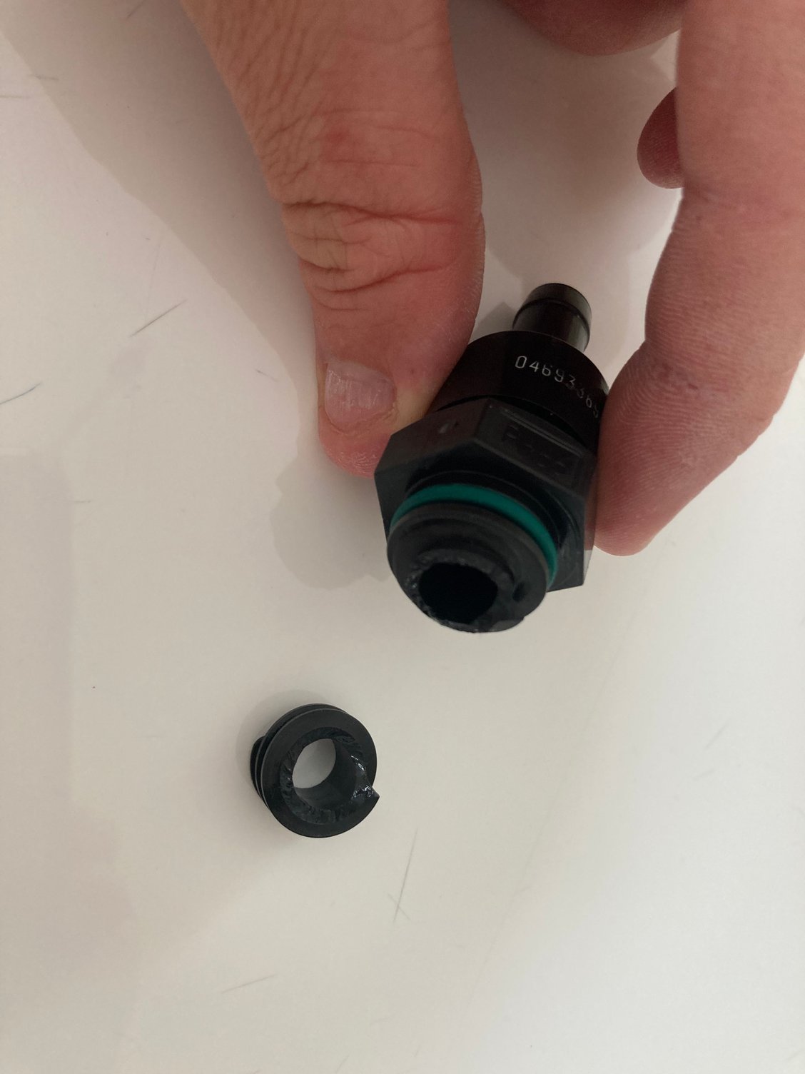

Same problem and same idea
Hey, I had same problem and came up with same solution. I have a 3 hour drive ahead and won’t get part in time. I’ve tried everywhere and due to Christmas can’t get the part. Fingers crossed, will post update when I Install the new one. The JB is good up to 550f
someone wanted photos of break - see attached

No good
No good. Glued it with JB. Left 24 hours. Screwed in and with almost no pressure it snapped at previous break. I have one on order but pain to get one this side of mid January

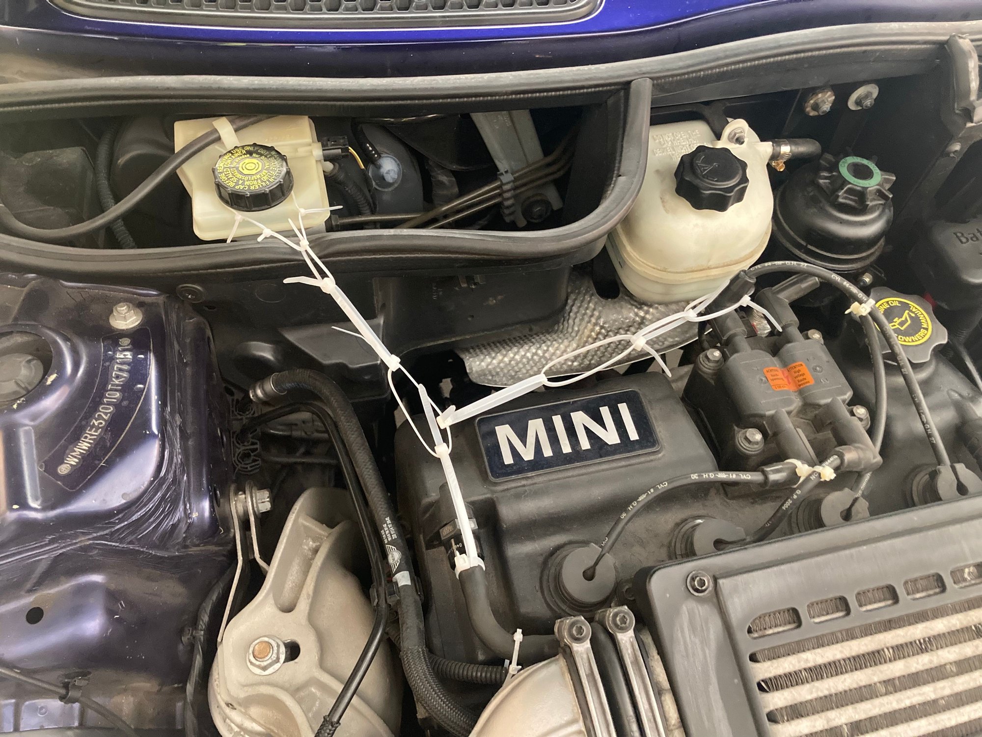

Bush mechanic solution (short term)
Cheers for that. I had ordered one, unfortunately shipping to Australia will be early January but I am on a trip 27th Dec. I went bush mechanic with cable ties to get me through till then. The o ring gives a good seal and the suction hose presses it in place, I just need to hold it in place for one or two good drives. It looks worse than it is
Old Dec 27, 2021 | 01:03 PM
Posts: 36,764
Likes: 2,552
Welcome.
I approve this fix.
