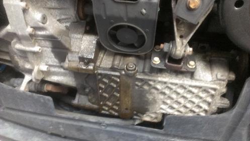

Originally Posted by MINIdave
oil pan gasket is one of the things every shop seems to try to sell, and I'll bet 99% of the time it doesn't need it. Replace the o-ring on your crank sensor and I'll bet your "oil pan" leak goes away too! The crank sensor leak runs down the front of the block and then follows the lip of the pan, making it look like the gasket's leaking - it isn't.
Try it, then clean the engine and see if it's still leaking.
Thanks dude ill try that also looking as if mini in the lift n u looking towards front bumper leak looks only on left

Looks like a crank sensor o ring to me. Mine looked the exact same, replaced the O-ring when I did the supercharger oil, cleaned it up, no more mess and it's been a couple thousand miles. The O-ring is cheap, just can be a pain to get to.
