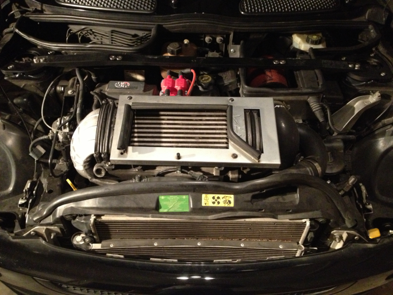

I was attempting to install some anti mushrooming plates on my 2003 MCS when I broke a stud loose on my passenger side front upper strut mount. Called my local mini dealer and to my embarrassment the mount is all one piece. The other two bolts are torqued down properly. If it was an emergency am I able to drive it for short distance? Has anyone had any experience replacing the upper strut mount?

The bolt breaking was completely my fault. I cross threaded the nut when I was putting it on. When I went to remove the nut to correct this it got super tight. With the extra force I applied it broke the stud loose from the upper strut mount. The bolt is currently still on the car it just spins freely. I will have to find some way to either get the nut off or cut it off. It is the one I have my finger on in my picture.

Well had a buddy bring over his dremel and we were able to get the old stud off. Now a trip over Home Depot for a stainless steel bolt and nut.

My problem is finally resolved! We were able to get a replacement bolt. I decided to go with a grade 8 bolt and nut. These are hardened more than any other bolt. The minimum strength of stainless steel bolts is 40,000 to 90,000 psi. The minimum strength of grade 8 bolts is 130,000 psi. Grade 8 bolts are much stronger than stainless steel.
Once we were able to smash down my mushrooming problem we torqued down the M7 strut tower defender with no problem. Final step was that brace. I will take it easy for a few days and check the torques.
