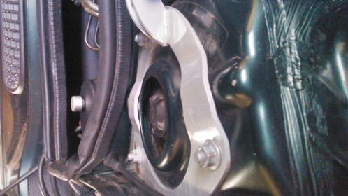

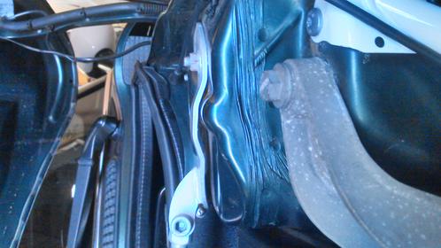

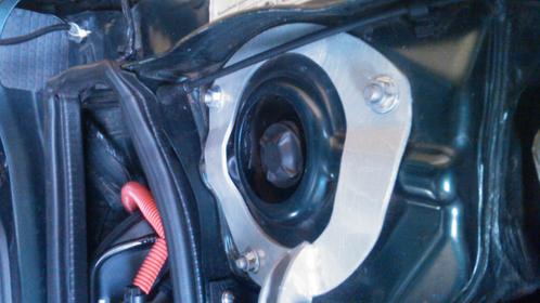

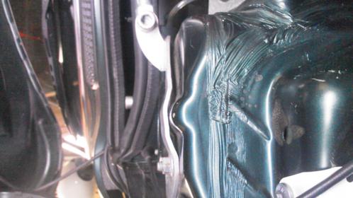

im about to remove my strut brace and ill post up a couple pics and see what you guys think. its hard for me to tell if they are mushroomed or not, but my strut brace doesnt sit flush, which leads me to believe they are.
thanks kims, but ive already watched that a few times. it is a good visual of what to look for, but it doesnt actually show you how to fix anything. in fact, there isnt really anywhere that does.
everyone just says "oh, hit it with a 2x4 and a hammer, its be FIIINE". well, i just did that, and it's definitely not fine. i hope everyone that encounters this problem reads this, and does it the right way, by placing top and bottom side plates and sandwiching it til it forms PROPERLY.
