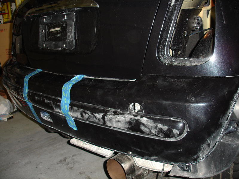

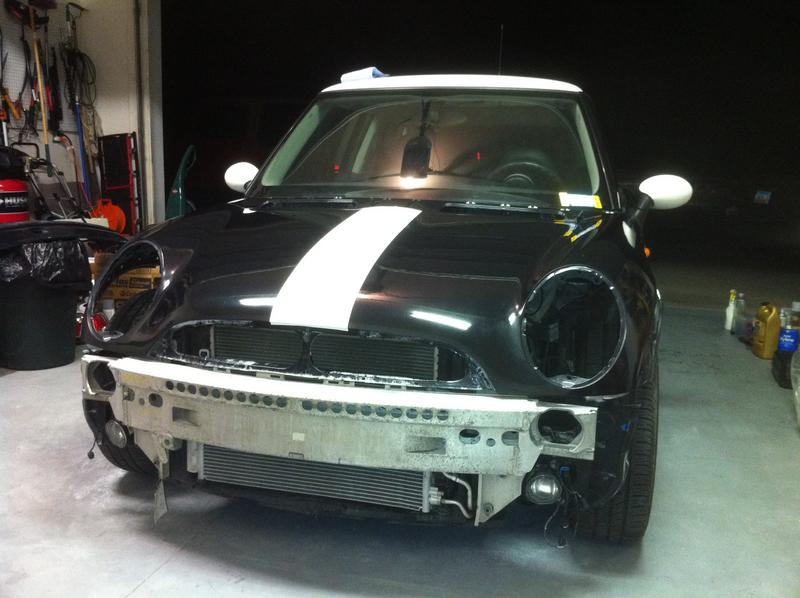

Here are some latest shots.
Added a racing stripe.
Please excuse the rubbing and polishing compound residue.

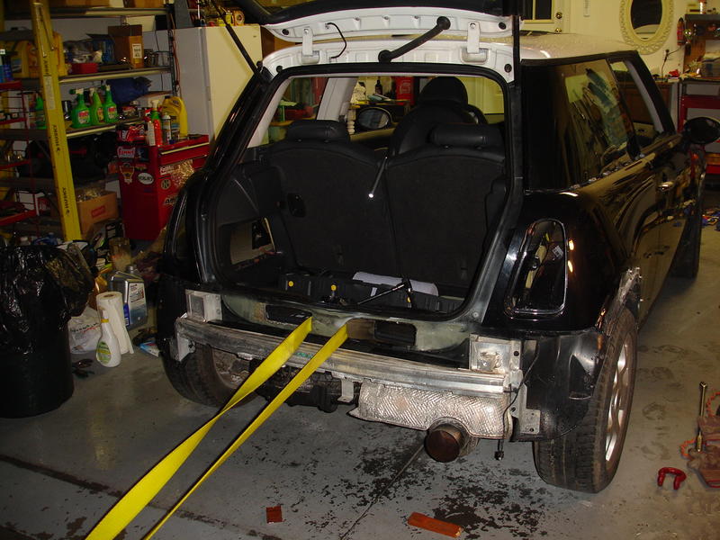

You would not believe what I did today.
I was trying to fit the bumper cover and I noticed that the tailgate would not close. The tail end has been pushed in that the contour of the bumper would not line up with the frame on the back. I sorta notice this to be a problem when I was fiddling with the tailgate to close without any bumper cover. I had to widen the holes for the tailgate actuator because I had to adjust it further out than how much the actuator would actually allow.
Once I noticed about 1/2" gap, my heart sorta sunk in because wasn't sure if this is something I can do it at home. Then I realize I got something very strong in pulling.
This is a DIY-home-frame straightening.
****** strap for pulling vehicle out of places. Looped around the shackle.
Attached on the other end is Warn M8000 winch on 4000lbs Jeep.
At first, either the Jeep or Mini would roll. I placed some weight on the brake pedal and the metal started moving. Kinda scary but the pulling wire moves about 1" a sec under no load I think. So I could regulate it pretty well.
Frame much straighter and the tail gate closes with the bumper cover on!
I hope you guys got some kick out this.

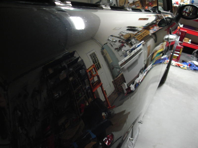

Little show off.. This is what happens when you wet sand, cut, and polish.
Better view of the right rear quarter panel.
Good night folks!

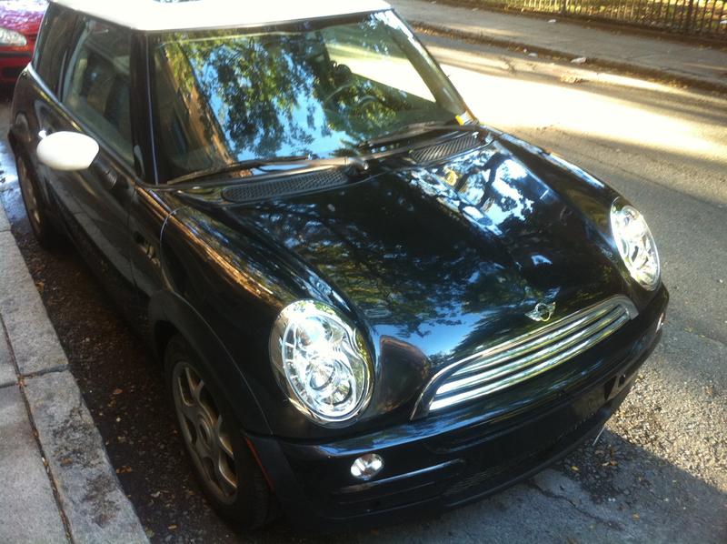

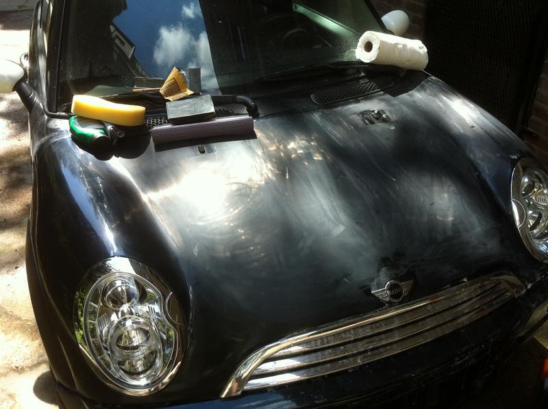

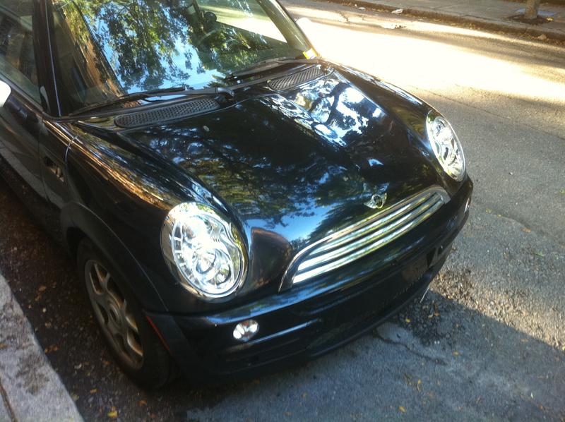

Finally got around to taking some photos. Got rid of the stripe.
Before...
Wetsanding after about 2 months of curing...
Polished/Cut Clear Coat...
Attached Thumbnails DDMini: R50 Salvage Rebuild Thread-photo-2.jpg   DDMini: R50 Salvage Rebuild Thread-photo-3.jpg   DDMini: R50 Salvage Rebuild Thread-photo-1.jpg

Very nice. I didn't care for that particular stipe myself. I think the car looks better without it.
I saw this on Autotrader (I think) a while ago and thought it would be an easy fix. You are my hero for keeping this R50 on the road. I was looking at Autotrader because my dream is to win the lotto and start collecting bad tranny/bad engine/light body damaged R50's and sending them back out there after being fixed. "Just MINI's; take your "S" elsewhere!" If nothing else, I have the name and slogan of my business ready to go...

The "before" picture kind of looks like an R56 up front
