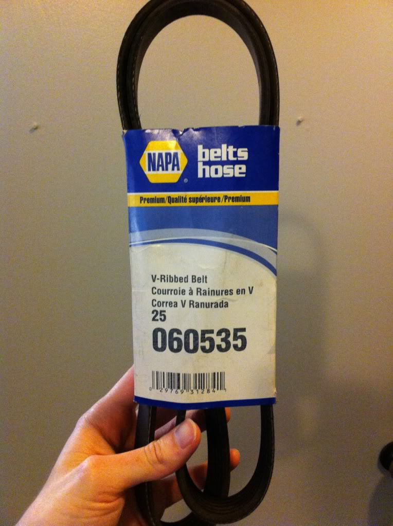

Old Aug 18, 2011 | 11:28 AM
minimic's Avatar
minimic
Joined: Nov 2006
Posts: 180
From: Memphis, TN
is this belt the correct one to use?
Old Aug 18, 2011 | 05:30 PM
MINI33342's Avatar
MINI33342
iTrader: (-1)
Joined: May 2010
Posts: 865
Likes: 37
yes
