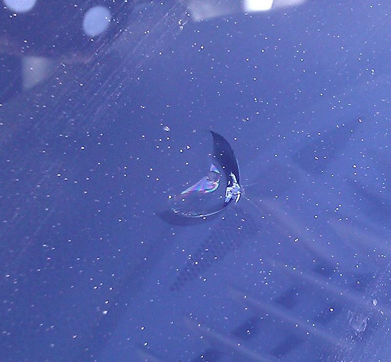

Hi all
Thanks to my new highway commute, I've got my first "major" windshield crack. Looks like it split nearly all the way through, but I'm no expert.
Could anyone advise me as to whether this warrants:
1) leaving it be until it gets worse
2) using some kind of product on it (i recall someone gluing a windshield long ago, i don't know if it worked or was snake oil)
3) replacement
if 2 or 3, please recommend product or service center (got my mini from hassel on LI, but if you recommend an independent shop in the greater NYC area, i'm all ears), and what I should be looking to spend. Stock or aftermarket? I've read a few windshield threads here, but they're all old, and i'm wondering if things have changed since 2006ish.
What really stinks is i wasn't even close to anyone. I have no idea where it came from.
thanks
Eric

A $15 windshield repair kit at the McParts store may be able to fix that.....unless you have zero deductible comprehensive insurance and just want to go ahead and get it replaced. If you decide to repair it you want to do it sooner than later, so it does not spread and turn into a crack that you can't repair.

safelite will come to your home or office and do an epoxy repair in about 15 minutes
many insurance companies willl cover this at no cost, what ever your deductible as it costs so much less than full replacement.
similar to the DIY but you don't need to worry about spilling the glue!
The mark will not disappear, but it will be sealed to prevent water from getting in there (which when it freezes causes more cracking)

I've done self repairs on a chip like that with an Autozone kit, and I've also filled in a 1 1/2 foot long crack with a similar kit. The crack has not spread in several years, including dozens of runs of the Dragon. If the sealant can hold the crack from spreading there, it can hold it anywhere. The chip is hardly visible.

+1
This is what I would do. If that spot was in my field of vision I'd replace the windshield.

Thanks for all the responses. I emailed my insurance company, and turns out i was really clever and had full glass added to my policy years ago. Turns out my original thought was that if the back window on my cabrio was to break, i'd be really boned, as i've been told they have to replace the entire top.
So i'll have the ins. company decide to replace or repair it to prevent propagation. I hadn't thought of what would happen if a tiny bit of water got in and froze, I should put some tape on there before it snows AGAIN
Fortunately, the crack is in the line of site.. of the passenger. So i can live with it for now at least.

Aside from the large crack that sure is a lot of pitting.
