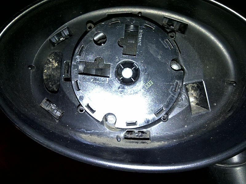

how do the tabs look guys?

The housing looks fine. A new mirror and you should be all set.

Considering how hard it was to get the replacement installed, I would think that it's much more difficult to remove it. The housing looks fine to me. Good luck!

Actually the mirror itself is very easy to remove on the Gen 1 MINIs. Slide your fingers under the bottom edge of the mirror and pull smartly. It pops right out. If you try that on a Gen 2 you'll most likely break the mirror.
If you've no CW package then the mirrors are not heated, thus no wires.
Install of the new mirror is quite easy (in most cases).
Whilst the mirror is out, this is a good time replace your mirror cover if you were wanting to.

got my replacement mirror today, yes it was very easy to reinstall loooks like someone just needed mine more than the $48 I paid!
