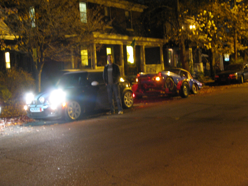

Three bikes, gear for a day and two kids.........doubles as a track trailer or for carting around a set of 4 tires/rims to the shop to be balanced....
.............You will probably just burn up brake pads more than anything else unless you predict your stops.

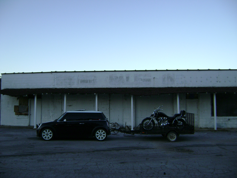

Here are a couple of things I have towed since installing my hitch a couple of months ago.

Which hitch did you install? Do it yourself? Thx, Dan

I went with the Curt hitch. I got it off eBay for about $125. I bought the MiniDoMore trailer light kit. Pretty straight forward install for both. I did the lights in just a few minutes, and me and a buddy of mine installed the hitch in about 45 minutes or so.

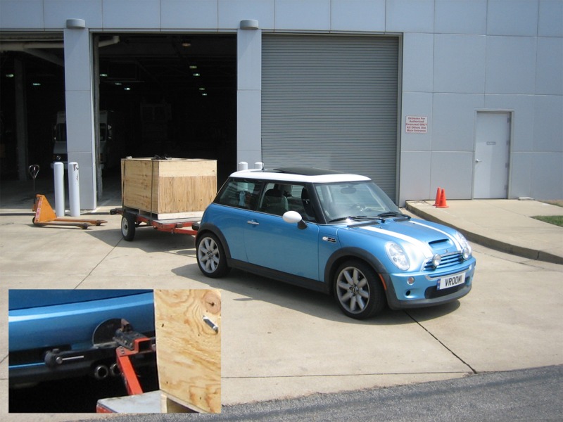

Howdy Chaps,
I've dragged this same trailer around since 1985, the first 18 or so years behind 3 different VW Rabbit Cabriolets often veeery slow going even with a GTI engine retrofit. Then came this MCS and better yet, the mini fini setup. What a game changer. Unlike other vehicles this size without such a large wheelbase with so little overhang at all 4 corners, this is the most stable non-truck towing vehicle for this trailer I've ever used. Keeping tongue weight in mind (heavier you load that, the choppier the rear ride gets and the more you feel the load trying to "steer" your vehicle) I've had 1,200lbs of construction material on board with no problem.
As I tend to keep vehicles a long time and as an antique motorcycle restorer am naturally mechanically empathetic towards my machines, so drivetrain preservation with heavier loads is all about being smooth and managing the momentum of your now heavier combined load vehicle. Once rolling try to avoid unnecessary braking or need for big throttle openings. As far as your vehicle's systems: suspension, brakes, drivetrain, all fullly capable, the possible weak links are your clutch and engine mounts, I try to roll off in first and 2nd (where torque multiplication is its highest) with as little throttle and hard pulling as possible to reduce the risk of trashing the uppler and lower mounts or glazing the clutch.
Keeping in the vintage BMW theme of fastlane's, here's my Steib in its crate then on the trailer to work where I then shipped this chair to Vancouver to its new owner. Also depicted is how the minifini setup looks, twin port receivers sticking through each of your rear grills. Great setup as you can also get plugin brackets for bikes and surfboards in addition to that trailer hitch.
Other pic is delivering my Velocette Thruxton to a freight forwarder who because this car's compact size let me drive right up forklift ramp into their warehouse to unload the bike into a container to go to San Francisco.
With the intro of this hitch, Mini practicality is elevated to a level where one really has no need for a pickup.
I'd love to see the detail of what you describe. Didn't see where that was depicted.
I'm planning on towing my thriumph in lieu of getting a touring bike...no offense to folks, but riding my bike through northern indiana, illinois, or ohio to get to fun roads is getting old.
