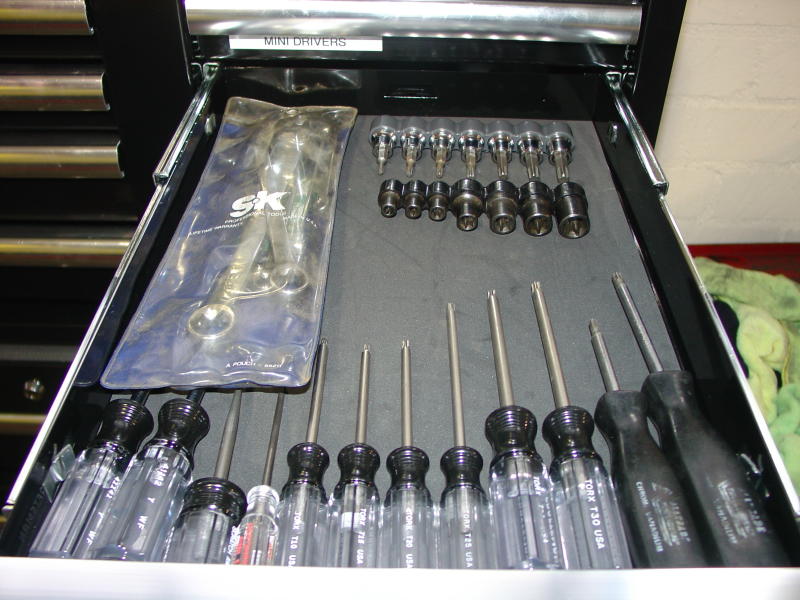

Because Phillips and Standard head bolts and screws tend to strip or cam out when you apply a good amount of torque on them. Cam out means that the driver forces itself out of the head once a particular torque is reached. Phillips drivers actually do this by design. Torx drivers are designed to apply consistent torque to a bolt without driving itself out of the bolt.
Torx bolts are also nice because they can dimensionally fit in places where a hex head is too large. The cabrio braces are a good example.
As far as what to look for.. You can usually find a set of male and female assortments from T10 to T50 at any decent hardware store or online.
Anything made by SK, Craftsman, Snap-On, MAC Tools. All of these brands should have a lifetime guarantee.
here's a shot of my Torx drawer at work.
