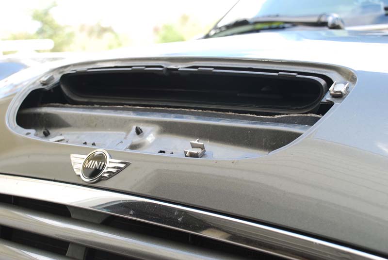

So, driving from socal to central coast today... cruising along at about 75 with the sunroof popped up and WHAM! something flies up hits the windshield, the sunroof and goes over the car; scared the heck out of me. Drive for about 1/2 mile and decide I should pull over to look if there is any damage from whatever I hit..... couldn't believe it, I didn't hit anything, my hood scoop is missing! put a scratch in the hood on its way off and hit the windscreen and sunroof. Went back to look for it but no joy and all the fasteners are still attached to the hood but are all cracked from where they would attach to the actual scoop.... crazy! Glad nobody got hurt, did a search and can't find it happening to anyone else.
Warranty? what do you guys think?

here are a couple of photos.
Attached Thumbnails Hood Scoop took flight today-dsc_5058a.jpg   Hood Scoop took flight today-dsc_5057a.jpg

yep, pretty crazy... scared the heck out of me. Dealer is replacing it; they said they had never seen it happen b4 but going to warranty it. Asked if I wanted painted or chrome... thought i'd try chrome.

I recently found both "rearward" tabs broken off. The bolts were there, just not attached to the scoop. Took the cheap way out for now. Lifted both corners and hot glued the scoop to the tabs without removing it...

I am glad I did this search. Just noticed the driver side scoop tab held down by the metal bolt was broken off from the scoop itself. I suspect long exposure to engine heat directly over the supercharger is the cause. Exactly like the second pix posted by slocraiger. Do you think the dealer will replace it under warranty? How hard is it to replace it with CF aftermarket scoop?

Dealer replaced mine under warranty with a carbon fiber one... no questions asked. Feel free to use my photos above if it helps.
