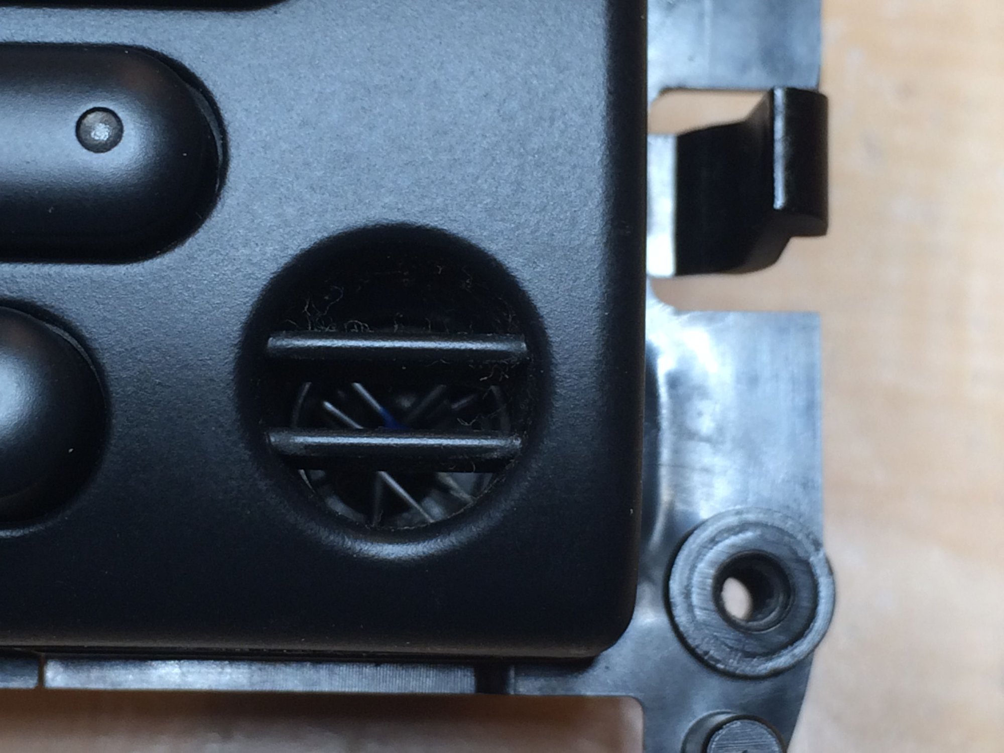

I came upon it looking for a solution to the same issue, I just thought it'd be nice to post my solution...with pictures.
I have an 9/03 R53, and every time I'd turn the key to the first position, and everything was quiet in the car, all I'd hear was this grumbling, grinding sound coming from the vicinity of the center console. I thought it must be the CD player, since my previous car was prone to a similar noise because it has a 6-disc in-dash changer.
I didn't really pay it much mind, until today. I was in a crabby mood and the noise really got to me. I pinpointed the noise and came to the conclusion that it must be the ambient sensor fan. Makes since, seeing as how it's nearly 13 years old and is always on with the ignition.
I didn't buy a new unit, or sensor. I just removed the controller and fan, and proceeded to my workbench.

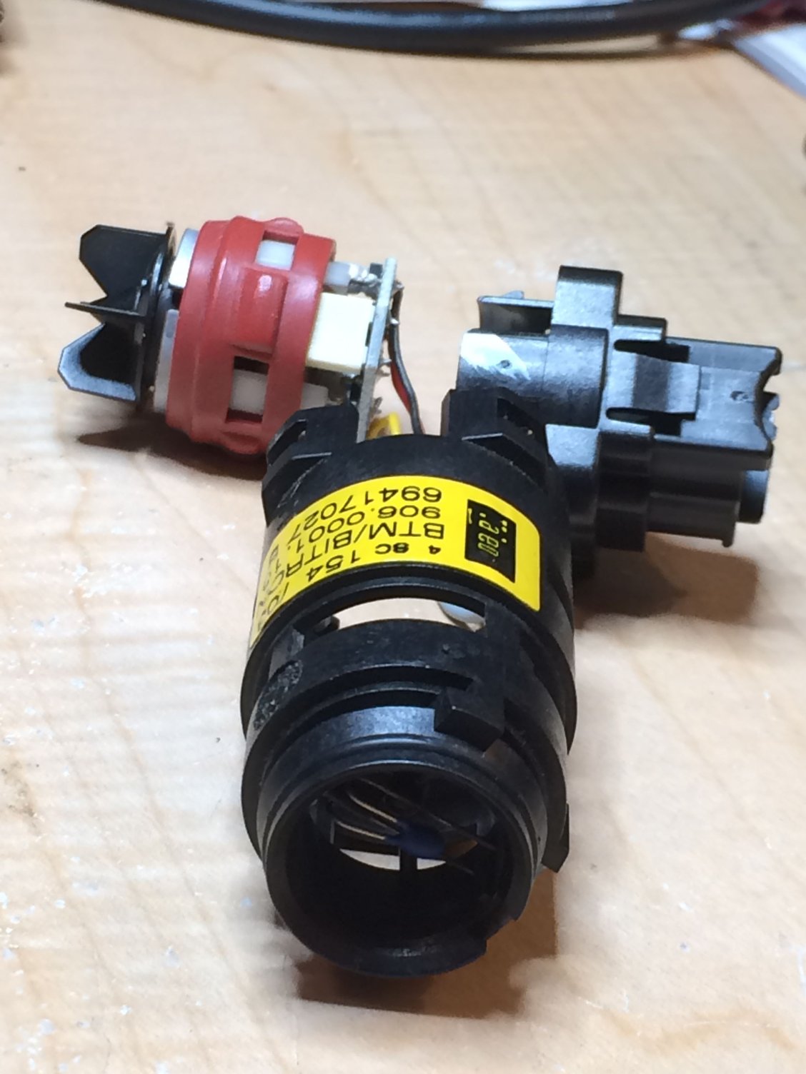

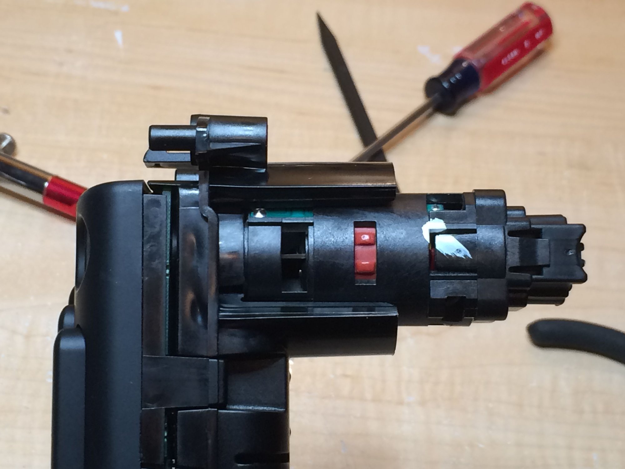

This gave me a chance to clean up some dried coffee that had splashed on the face of it some weeks ago. I cleaned and dusted it. Then, I took the fan assembly apart and, under further inspection, noticed that it's really similar to a fish tank water pump. The fan/impeller floats on a spindle inside the stator. I simply greased the spindle with a small swab of lithium grease.
Once back in the car, everything was as quiet as the day Tina came home!
It's a pretty easy job, but make sure you use a plastic pry tool or equivalent. These are currently ~$70 on ECS, not a bad price considering the part, but still...
let's get that face offf
it has a pretty complex control board for being just a fan...
applying the grease...
ahhhh...lube

like a little jet engine with an afterburner

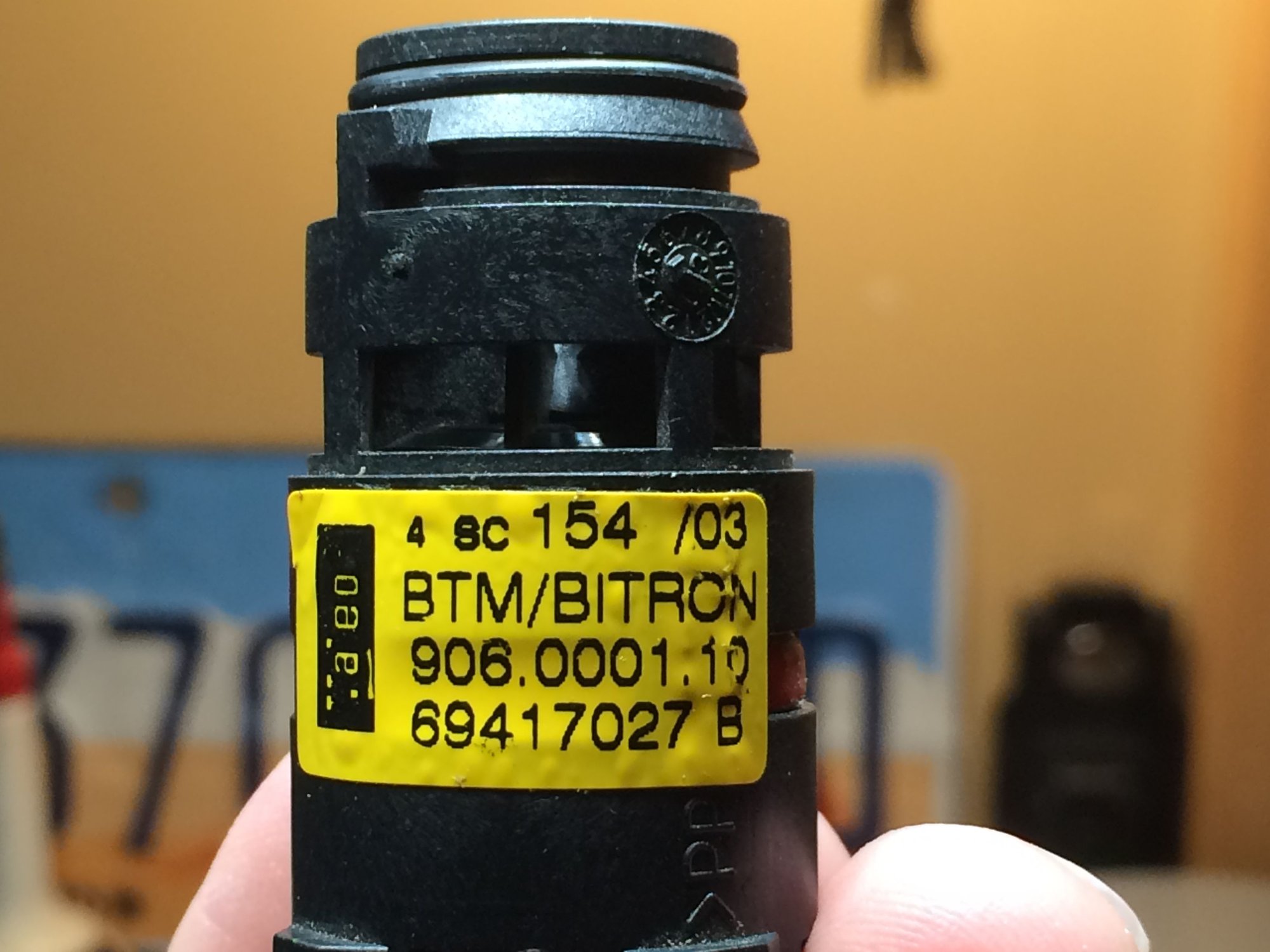

it's made by Valeo
six connectors, two for the sensor, four for the fan
