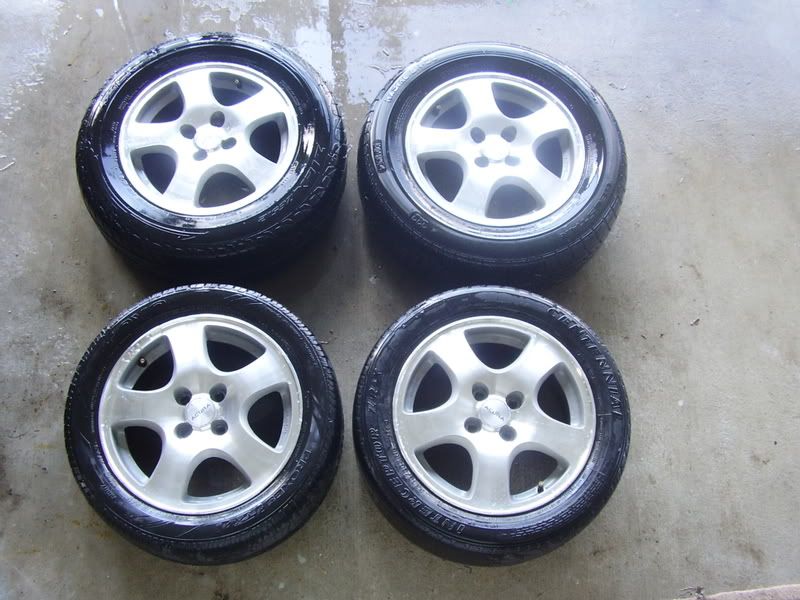

15x7 stock rims from an Integra (1992-1995)
i THINK they're a 44 offset.
and im pretty sure i just have the normal S breaks, not the JCW. not 100% sure though. how can i check if these will fit before i buy them (they're about 1.5 hours away)
i like the style of the rim and id prally paint them flat black, or maybe gold to see what they look like

They are only 15x6. The bolt pattern is the same as the Mini, but I don't know what offset it is. If the person selling them is telling you they are a 7" wide rim, don't bother dealing with him...
i would have him take a picture of the back honda/acura has all the measurements stamped on the back there will be a 15x?jj and possibly the offset. and if i remember correctly the normal offset is a +42mm
i believe it is a 42 offset.
for 300 bux for those rims in the pic, with tires, which look to be good tires and not bald or anything, thats not bad. just to have some other rims just to switch it up every now and then
you don't have the JCW brakes.
42 offset for 6" wide or 7" wide will fit.
will it clear the front caliper? i don't know about that. you'll have to do a test fit. you might need a 3 or 5mm spacer to clear teh caliper if the spokes don't leave enough room behind them. you should test fit them on the rear too, i remember a 15" wheel by enkei not clearing the bolt at the bottom of the suspension.
