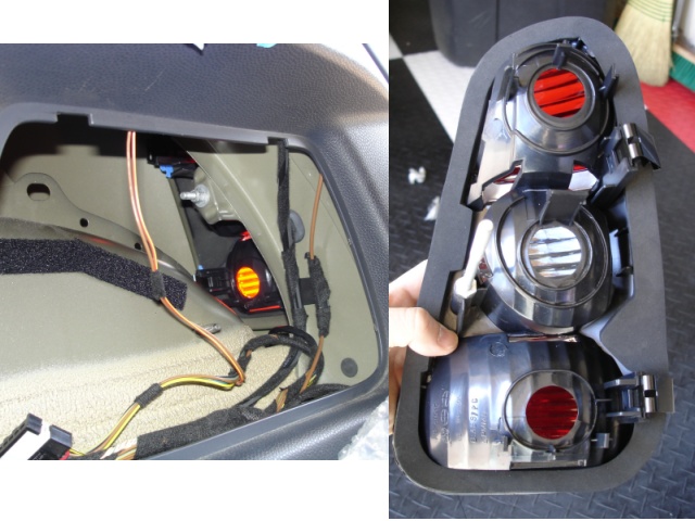

I wanted to get a quick tip how to remove the tail lights from my 2003 MCS. I found a guy who will trade his factory clear lights for my stock ones. I took the hatch cover off to get to where the bulbs are and I didn't see anything that would let me remove the tail lights. I will look again with a flash light but I wanted to see if anyone could give me a quick tip.

05+ comes off with a 10mm nut and 3 clips
im not sure if it's exactly the same to the 02-04's

So just one nut holding it in +the clips? How hard is it to get the clips off with out breaking them? I am doing a trade and the guy I am getting them from isn't knowledgeble what so ever about the Mini. So I want to make sure I dont mess mine or his up.

they shouldnt break, they're metal clips
they do require a bit of pressure to squeeze in. 2 towards the outside of the car, 1 towards the inside of the car. you may need to push the lights out since they could be pretty well sealed to the car because they havent been removed over time. it's just a foam seal that shouldnt break/tear either

Yes, one nut and three tabs on all years. Just remove the plug from the back of the housing, remove the nut, and then push out. The tabs vary, I've seen some just slide out, and others to a little more wiggle. Don't worry about breaking the tabs, I'm pretty sure they are metal. Oh and its a long threaded bar that the nut is attached to. So you need a wrench and some patience to get it started, then you can use a socket.

just to add a pic...
these are from '03 mcs.
removing it was easy, it's reinstalling it that was a bit difficult; had to push hard (even pressure) to get the two clips to secure.
Attached Thumbnails Tail light removal? No answer with search.-taillights640.jpg

Thanks for the pic. That will help alot when I take them off.

helps if you have a large suction cup and pull it out after you remove
the nut.
i used a large suction cup bracket i use for PDR. worked like a charm.
