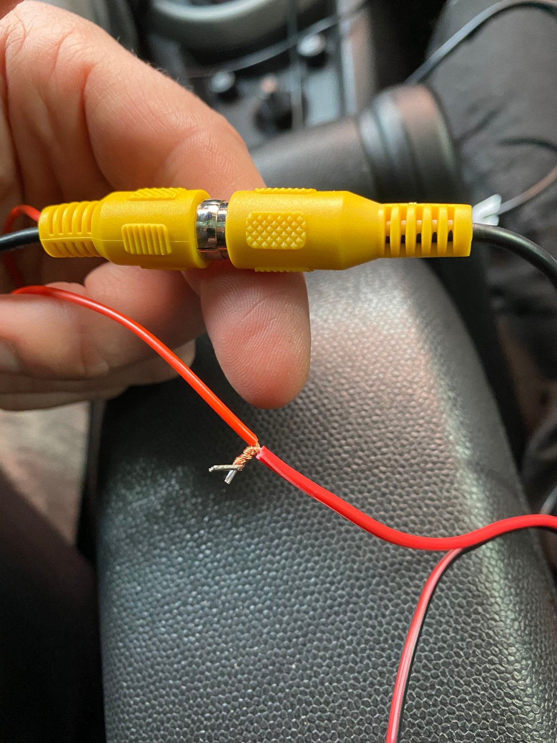

My current camera test setup-and nothing works in REVERSE or when I go to CAMERA in the menu options-I tried ORIGINAL setting and AFTERMARKET, I get NO SIGNAL on the camera icon menu thing....and of course I won't leave the splices raw like this haha.
RCA from camera cables into andream and red to red.
The back end rca, and red to red

Plugged camera into FRONT rca and went to camera setting and I can see camera working, so, it does work, then turned off everything and put into the reverse rca and nothing happens when I put in reverse-and nothing happens if I goto camera icon on Andream menu.
im full of fails!

Ok, let is run for a minute, then did reverse, still nothing.
there are only one red wire on each towards the andream unit, but further back on the camera wiring, is that little mini 4 pin connector on my camera and a red wire, then a red and a black/red wire, I am connecting the red, should it be the black/red?? (seen in this pic)
https://cimg4.ibsrv.net/gimg/www.nor...75ffda961.jpeg
Old Dec 28, 2021 | 02:10 PM
  #84
MReiland's Avatar
MReiland
Joined: Mar 2019
Posts: 216
Likes: 48
Just the red, because it worked when you plugged it into the front camera and it worked you are good camera power wise.

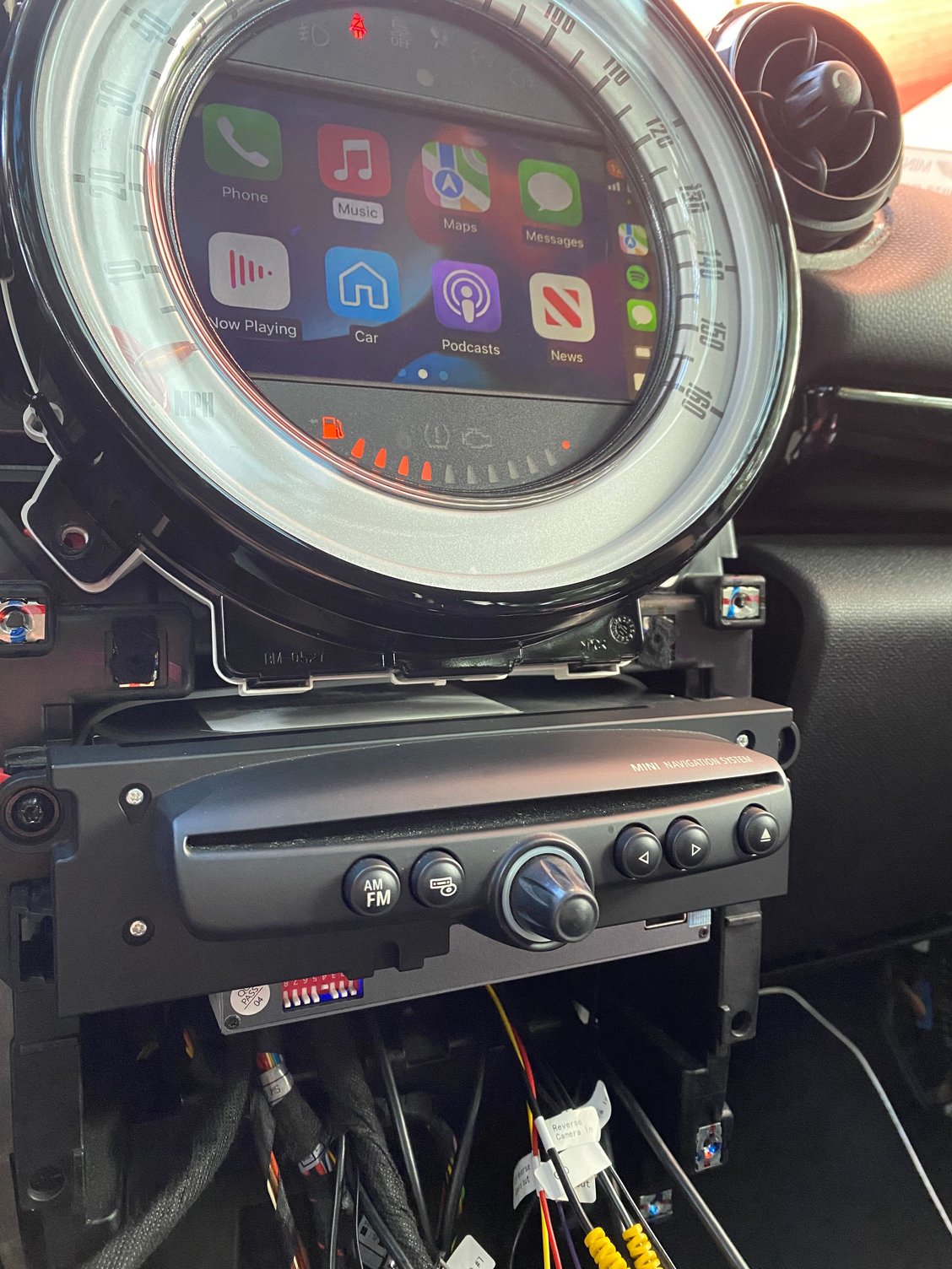

Regarding screen size-is this as good as it gets?
i switched it to right hand drive
Old Dec 28, 2021 | 03:57 PM
  #87
MReiland's Avatar
MReiland
Joined: Mar 2019
Posts: 216
Likes: 48
This is correct, now you can play with the left and right scrap setting to pull it in a little so less gets cutoff by the round edges if you want.

If anyone cares, I finished this insane project lol.
Thanks all for the help.
Still have to put the backup camera in, but, I prewired and tested the camera, will do that another day.

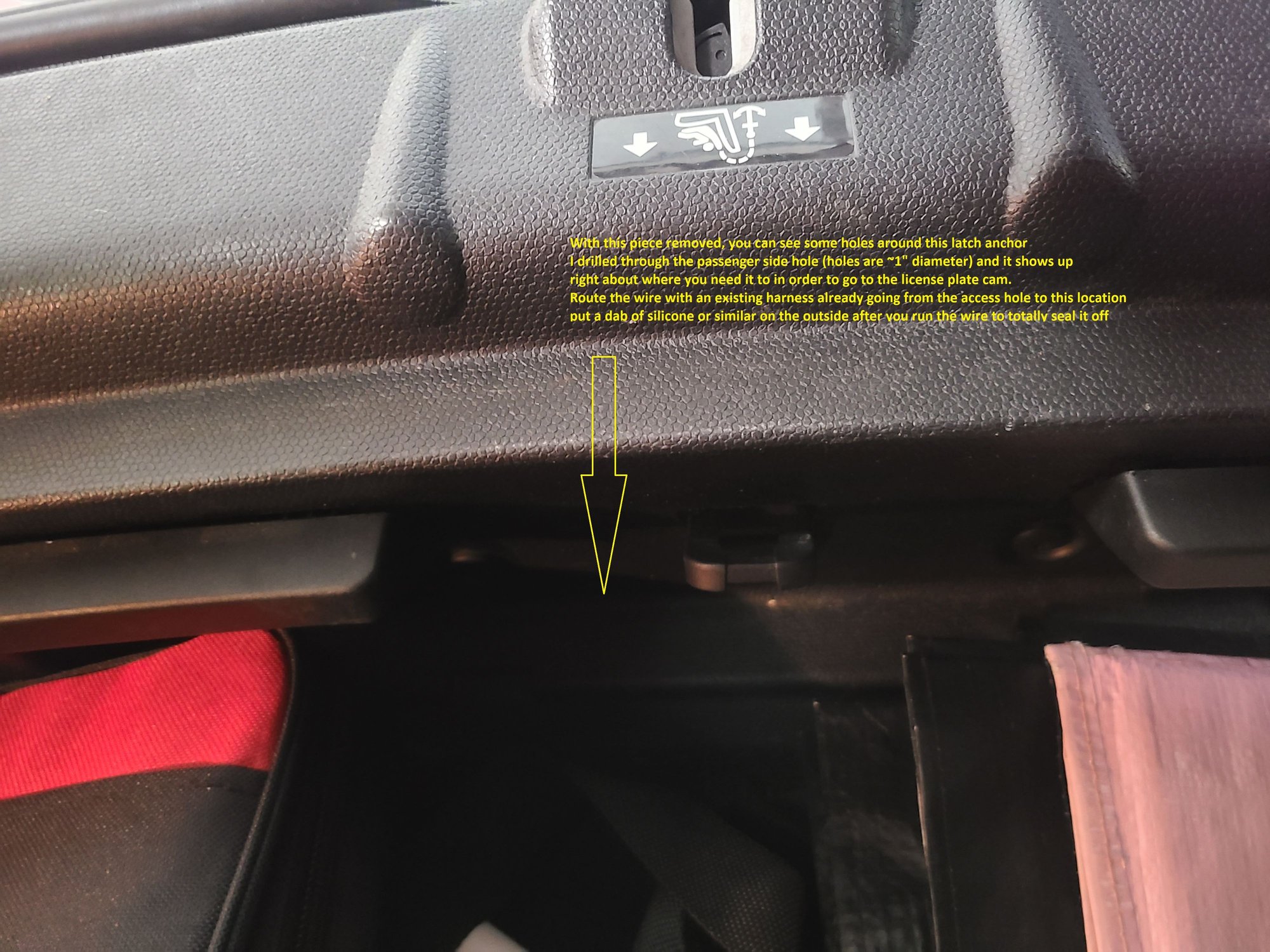

Here's my setup, it took a little while to find this route but now that I found it, it was pretty simple to install. (Much easier than the Car Play unit!)
COOLINT BACKUP CAMERA:
Amazon Amazon
Step one for the camera wiring is to run it with the harness behind the glovebox while it is all apart and down the A-Pillar. You will have to remove the trim from the passenger footwell and run towards the back of car
Fish the wire behind the B Pillar and lay into the trough exposed by pulling up the weather strip. Pass the wire to the trunk area up high (mid shoulder level there is a clear route to the vent in the back)
Pop out the rear vent access and fish the camera wire to this point
Pop off the piece of trim across the back of the trunk to expose a nice place to pop the wire through to the bottom of the car. I chose to use an access hole next to the Center latch anchor. It will require about 1/4" hole to be drilled through in order to clear the little 4 pin cable off the camera.

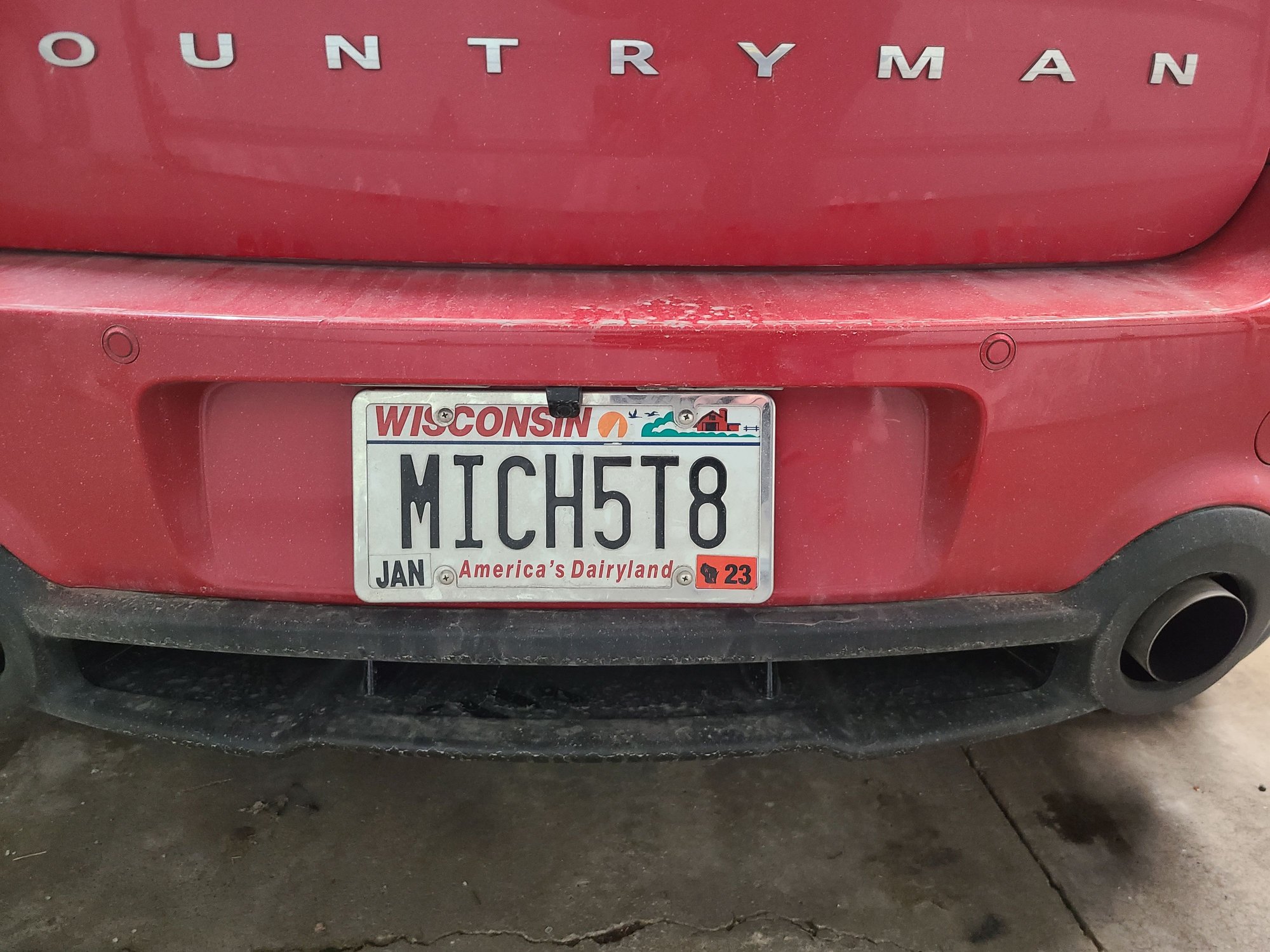

Initially I was getting an external interference alarm for the TPS (Tire Pressure) system. I pulled the wire over a little bit which was probably enough but then stuck a piece of foil tape over it and never had the problem again.
I mounted the camera right above the plate. I centered it here but it would be easier to get the backing screw on if it was biased over one side or the other. (You pop out the license plate light to get your hand in there) the wire comes up over the crash bar and then into the hole you drilled in the trunk.
