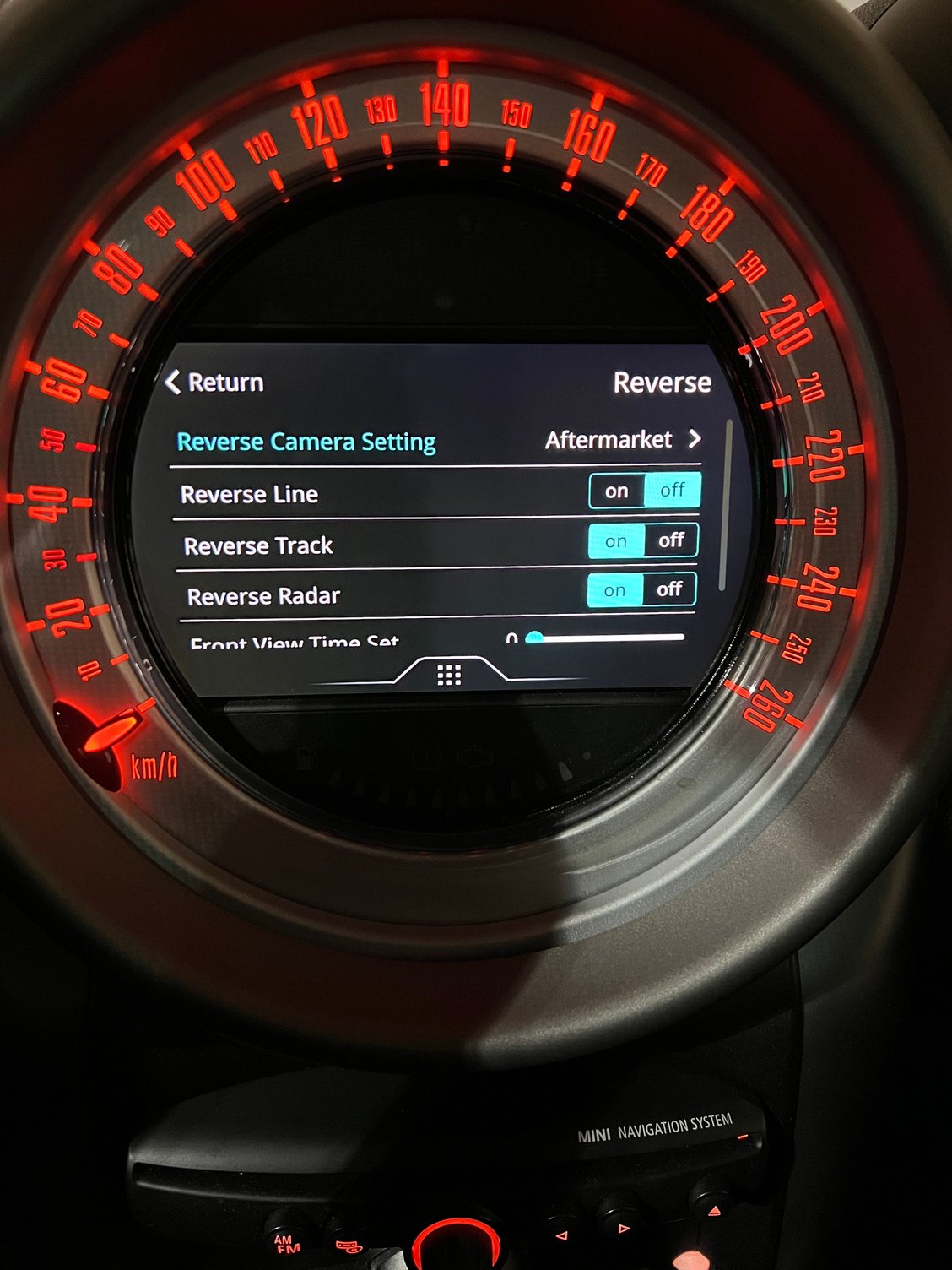

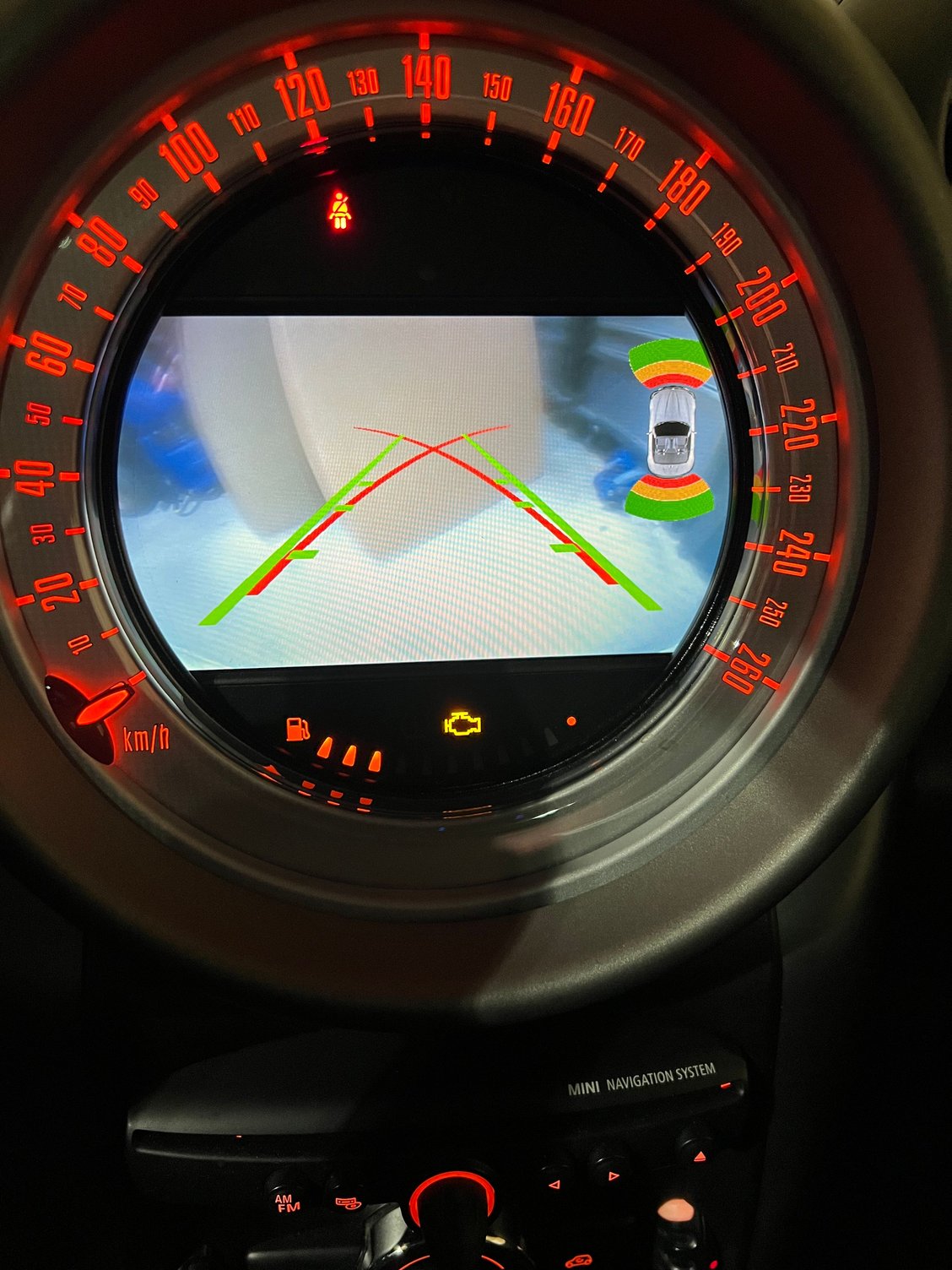

That's interesting. I actually haven't done a car with the PDC (parking sensors) where we didn't do a backup camera.
In the settings, there should be a setting for Reverse Radar. That will display your parking sensors:
It displays a little radar thing:
'You might also try switching between oem and aftermarket camera and see what that does.
I don't think it's really designed to not have a backup camera.
