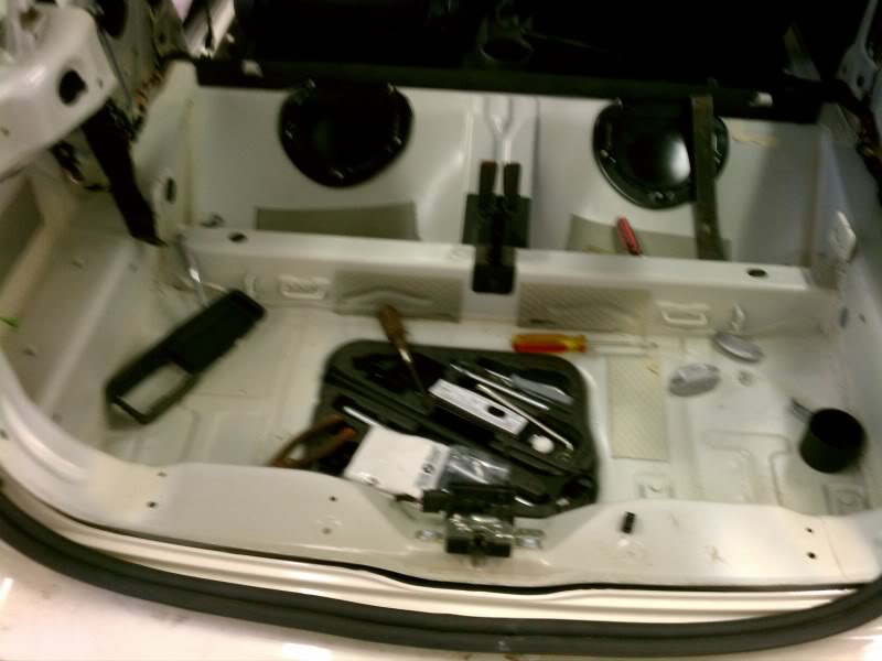

Hey so I tried searching and read thru like 16 pages here anyone have a picture of a place where I can ground my amp and cap? I know this is speaker replacement but some people have led it off to amp replacement as well.
Im installing a 12w7 and a JL 1000/1 amp and need a good ground spot. Then maybe upgrading the existing
Oh and not sure if it matters since im just asking about a ground spot but I do have the upgraded Harmon Kardon or HiFi system.
Since there hasn't been a response to this, I'll just give my 2 cents (if worth that much...).
If I remember correctly, I'm pretty sure initially my installer used a ground beneath the wheel-replacing tool kit. In the end, though, he believed that manually making a ground would work better, so that is how it is right now. I don't have the greatest memory, perhaps due to a brain injury 5 years ago, but I do remember an accessible ground around that area.
Added a picture just for kicks.
There are tons of ground plates around the car, so depending on where you install the amp, there will most likely be a factory ground plate near you. I wouldn't worry too much about where until you start pulling off some panels, and it should be easy to spot a proper ground location.
There is a common ground point a couple inches in front of the amp, on the drivers side in the trunk area. I used that to ground my amp and have not had any issues with ground loops or anything.
