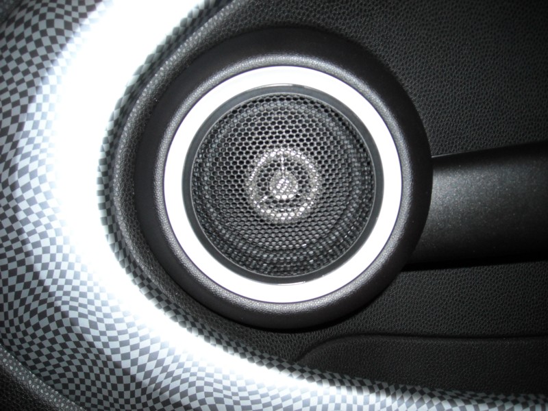

For what it's worth, without hassling with an amp on a standard system, I'm cranking out incredible sound in my 2010 for under $300
Front/Rear Channel Swap...No cost
JVC CS-BB2 Powered Sub in the rear...$100
Polk Audio DXi650s (92db) in the lower front doors...$100
Polk Audio DXi350s (91db) in the upper front doors...$60
Total invested: $260.00 plus tax and a lot of labor (but it was worth it)
The sound is incredible, it was a complete make over. Run my "eq" at +2 to the rear...bass at +2...treble at -1. With sensitivity of the Polks over the 90 mark, it's hard to believe it's just a standard audio system. And the Polks have more than enough headroom to add an amp later if I want. Only thing I have left to do is a swap of the rear 6x9s, but I doubt I will. The sound I have now is more than satisfying to me.

Why not use the factory tweeter location, in front of the arm rest, to mount your tweeters? Those OEM speakers are not going to be used in your setup any, right? I wouldn't since they are not even in the same category as your polks.
Tweeters need to be angled so that they are literally pointing at you when installed. You'll like them if you mount them flat... But you might like them more if mounted angled Towards you.
