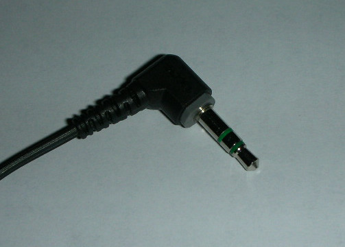

Yep, that's a mono cable, you need go get a stereo cable. You can find one at any electronics shop, Best Buy, Radio Shack, etc. Ask for help if you're unsure. You see that black band? A stereo cable will have two bands.

Here's an example of a stereo mini-plug. This particular end has green bands, but you get the idea...
EDIT: just saw your link; yes, that should work.
Attached Thumbnails Aux input cable weirdness (Ground loop thing or not?)-mini-plug07.jpg
