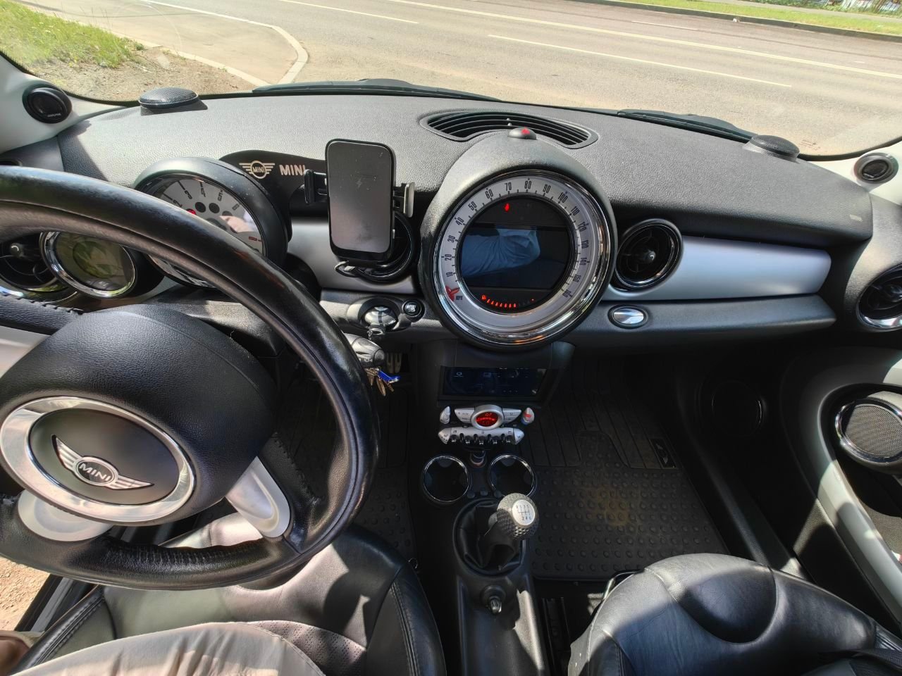

A small **** under the shifter controls the MAIN volume from the DCP. Since my R56 is manual, and my hand is all the time near the shifter, it works perfectly.
Three buttons in front of the shifter control the DSP and tweeter positioning—we’ll get back to those after the amps.

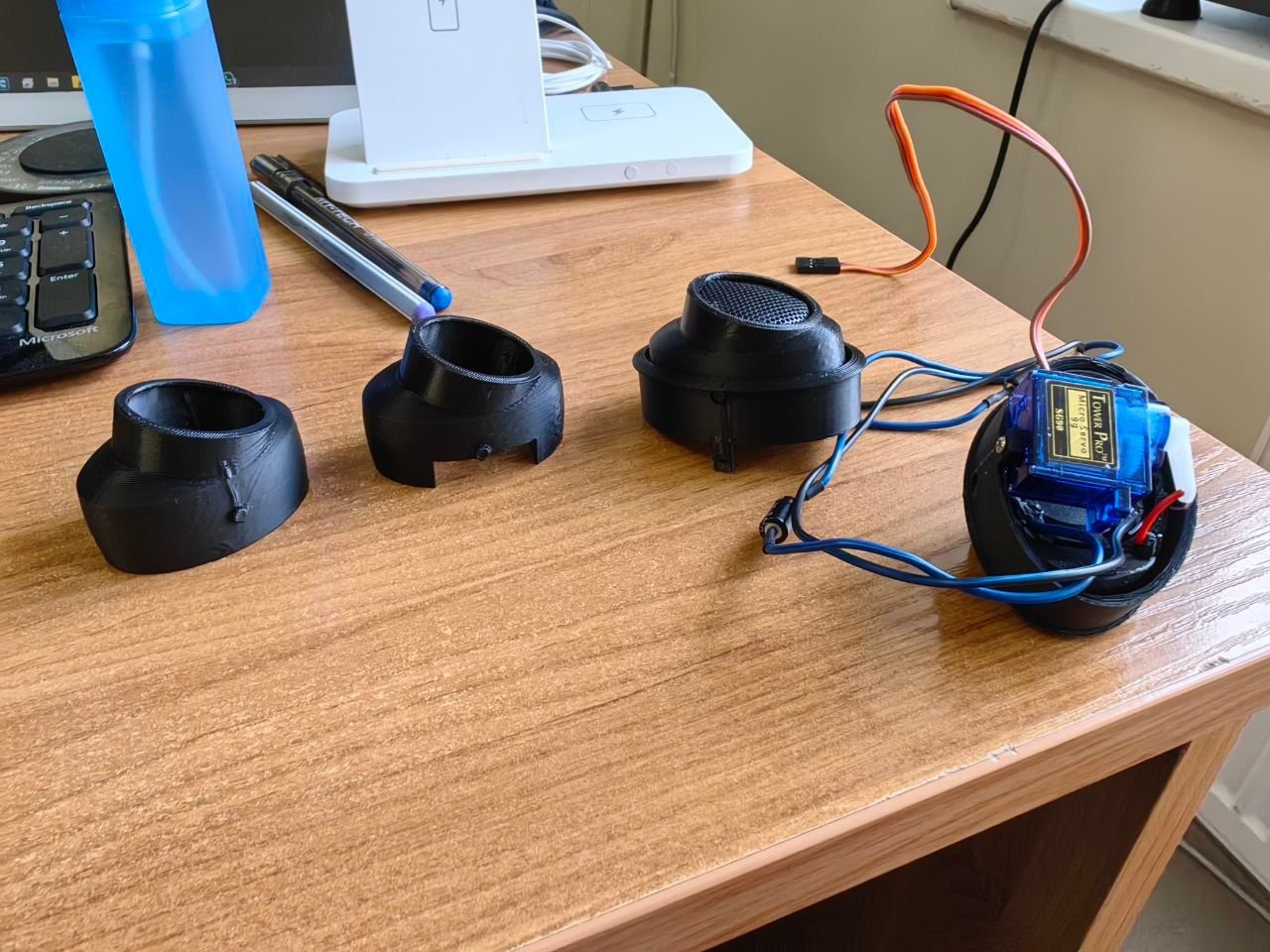

The biggest issue? Tweeter positioning. For proper sound staging, tweeters need to be aimed at the primary listener.
Mine are mounted on servo motors, so with the press of a button, they rotate toward either the driver or the passenger ( Video: https://t.me/car_audio_hobbit/154 ). Naturally, the DSP also adjusts delays, filters, and EQ to provide the best possible stage for each seat.
Midrange speakers in the doors were a no-go—my left knee completely blocks the factory left-side location. So I mounted them on top of the dash instead.

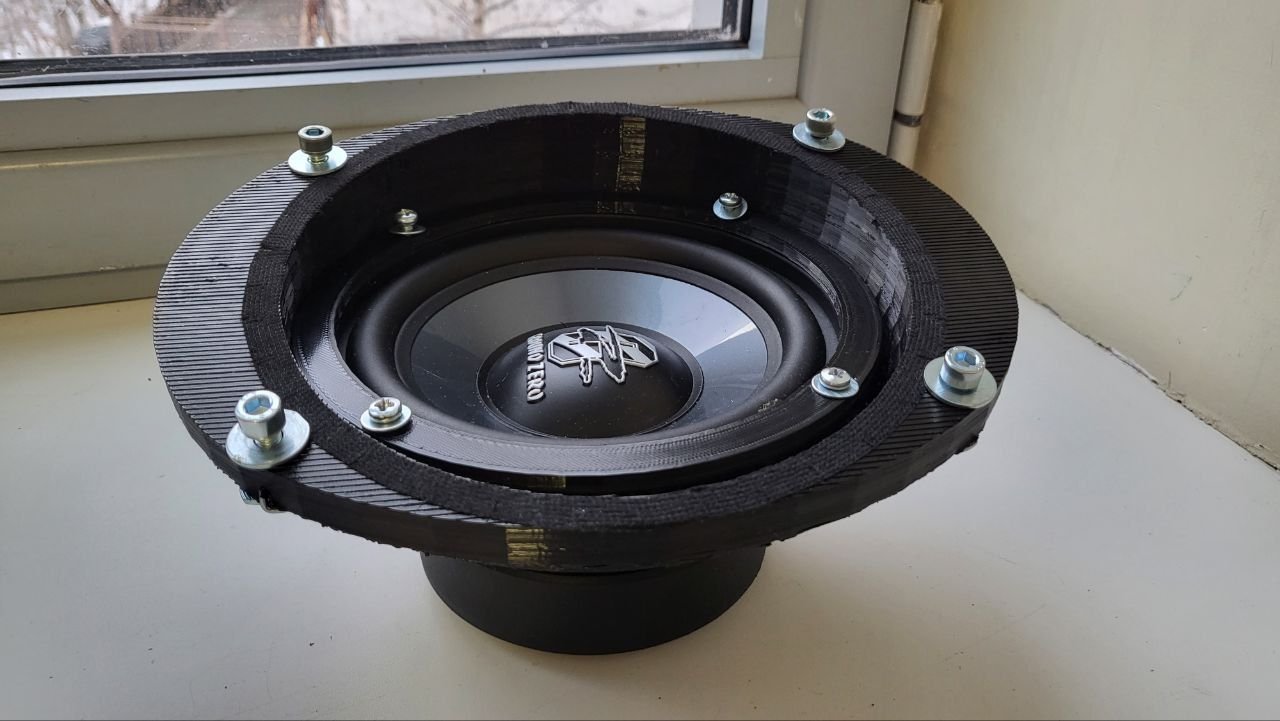

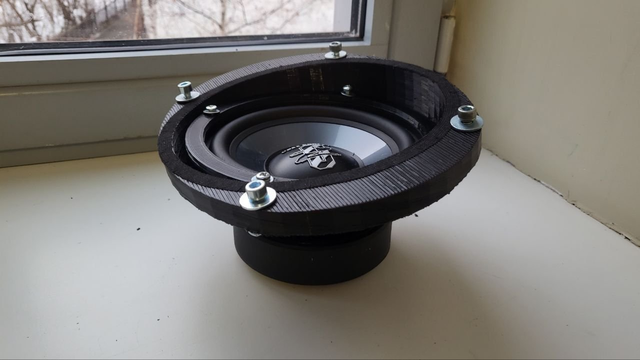

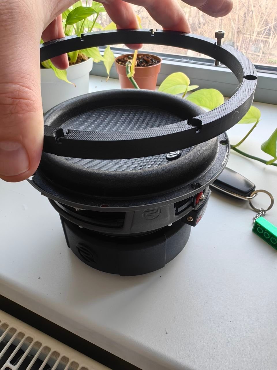

Woofers are in the standard locations, secured firmly with a bit of 3D printing for proper fitment.

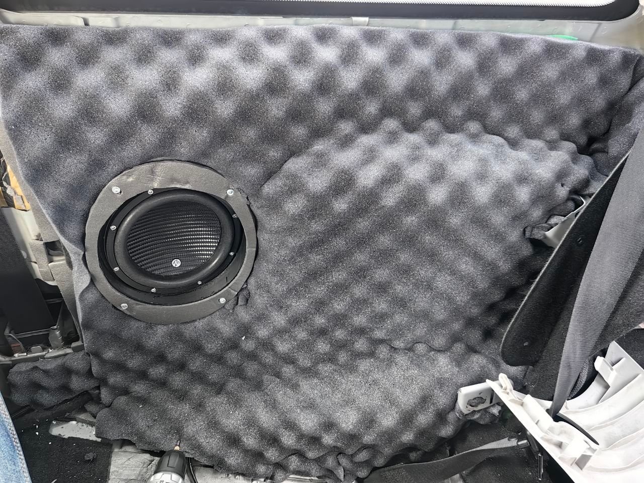

Needless to say, every panel that could resonate was deadened.
I added extensive soundproofing—starting from the wheel arches and finishing with the roof. Without that, everything I wrote above would be pretty much pointless.

How did you access/dampen the rear wheel arch panels? i.e. the large, outer surface area between the rear lights and the rear speakers, which is not accessible from within the rear speaker enclosure space. Do you possibly have any pictures of that?
I have found that they vibrate loudly even at moderate volume sub-bass frequencies (or high volume high-bass frequencies) emitted from a full-range 6x9 retrofit speaker (Hertz ECX 690.5, driven by a power amp). Extensive dampening of the inside surfaces accessible from within the rear speaker enclosure space has no effect.
Old Jul 21, 2025 | 03:58 AM
PeaceVam's Avatar
PeaceVam
Joined: Sep 2017
Posts: 18
I definitely remember that tunnel. First, every piece of plastic interior paneling behind the doors came out of the car, then the speakers and rear lights. The last piece was a removable foam panel inside the tunnel behind the speaker, so I pulled that out too. That gave me probably the best access I could get.
I deadened the metal as much as possible, added a layer of self-adhesive acoustic foam, and put everything back together.
However, there was still some rattling in that area. A few months later, I went back and stuffed the tunnel with acoustic felt. That finally solved it..
I’ll try to find the pictures, I think I took a couple that day, but I’m not completely sure.
Driver’s side was not much better. The space behind the sub was so small that the sub was essentially overdamped (if that’s the real term, probably not). Basically, the speaker itself started rattling at higher volumes because the space behind it was too tight (it was like it tryed to jump out of the magnet). I ended up replacing it with another 6.5-inch sub that had the smallest VAS I could find and that solved the issue.

I tryed a plenty of 6x9s. None of the worked, so I 3D-printed a crossovers for 6.5" subs
