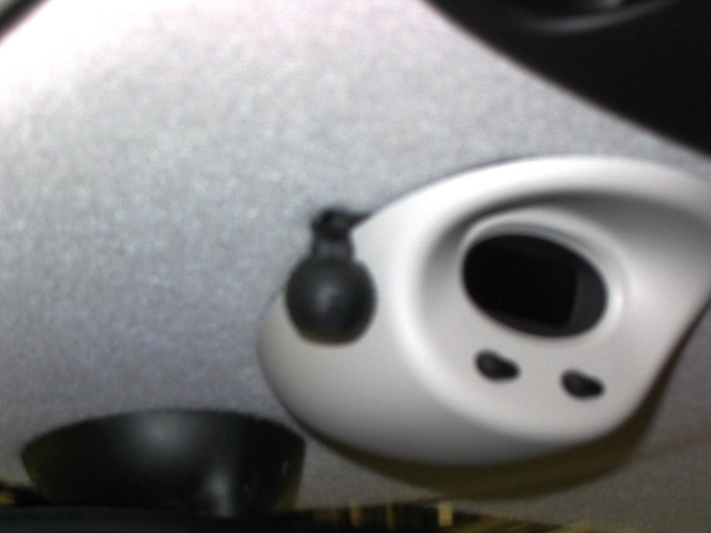

Well I finally got the Nokia CK-7W Bluetooth car kit today. I have managed to install the parts you will see as well as the bluetooth brain. I am including some pics of where I put the mic and the button/controller. I do not have it operational as of yet because I am waiting on some parts from newministuff.com (from the UK) to allow me to integrate it with my HK system so it will play through the car speakers and mute the system at the same time.
So for now you get the pics of the installed setup for looks. I will post feedback on the function hopefully over the weekend (supposed to receive the stereo integration parts tomorrow or the next day).

OK- Here are the pics finally!

Just got the first of two HCB-300 kits (one for the MINI, one for the Subaru). The one in the Subaru is going in first, but I was thinking of putting the controller in the MINI in about the same place you put yours. The Sony controller looks to be about the same size just a different shape.
I'm thinking about putting the mic on top of the little grill in the headliner where the clock is in the '02-04 and maplights are in the '05s. I'm not going to put the mic behind the grill b/c I hear that it causes really bad sound quality, so I figured I'd put it on top of the grill....

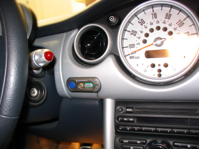

I have the Motorola Bluetooth kit. I had it installed about 3 months ago. I love it,it mutes the radio when acall comes in and is so easy to use. If your interested in bluetooth you should check it out. The only draw back is the price of the unit and installation.
Attached Thumbnails Bluetooth Kit installed!, PICS-bluetooth-2.jpg   Bluetooth Kit installed!, PICS-bluetooth-1.jpg

The biggest thing to be careful about is the length of the control cable. The one with the Nokia isn't bad but I located the brain behind the side panel of the dash on the drivers side by the door. I was rewarded with only 1 inch of extra cable from the controller by the time I finally got it there. Another good place for install is in the blank space under the steering wheel.
Also be careful with the little plastic cover (where I moutned the control) pulling it off. It is a bear to yank off and I managed to break one of the securing tabs but in remounting everything I was able to get it all secure.

The mounting location I have for the mic (see pics above) works great and people don't have a problem hearing me!

The Kit was $150 at verizon wireless plus $100 installation fee.
What i liked about that was verizon came to my office and installed it,and the guy really knew what he was doing. He had previously installed bluetooth kits in MINIs.
