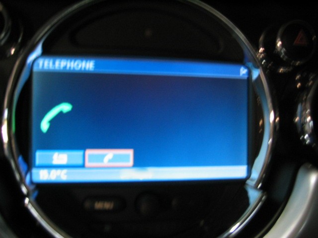

Navigation & Audio Bluetooth Kit installed!, PICS

This kit does not interface with the NAV, there are no kits right now available that interface with the NAV using Bluetooth.
As for the update on my kit... Dr Frankenstein was running around my cul-de-sac this evening screaming "IT'S ALIVE!!!!!"
That audio connector seems to have been the culprit. Despite looking like it was well seated, unplugging it and re-seating the connector appears to have worked.Initial reports: The sound appears to come exclusively through the front left speaker, but it's crystal clear. I've been told that the outgoing sound quality is MUCH better than the kit in the Subaru, I mounted the microphone on the headliner near the mirror. The radio doesn't display PHONE like I thought it did, but it does mute the sound and that combined with pumping the audio through the car's speakers was the goal of this evolution so I'm happy.
