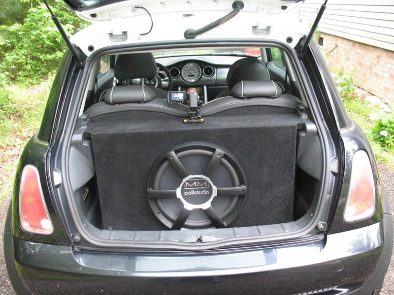

4 SA-12's powered by an AQ2200. Box is 7.25cuft tuned to 33hz with a custom 10" aeroport with a 15" flare. Nothing crazy
