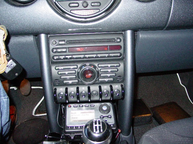

Since I don't use the space under the AC controls, I mounted my Sirius Shuttle PNP unit there.
The upside, it's visible, yet out of the way.
The downside, I've lost the use of the two small cupholders as the mount sits right on them. The cigarette lighter is always in use because the Shuttle is plugged into it, and blocks access to it. Plus my wife has weakened the secure mounting that I had by constantly unplugging the Aux connection so she can plug in her iPod.
I've added an additional power outlet in the parcel shelf, which is a much better place anyway for us. Plus my antenna is mounted on the dashboard and works quite well. Honestly I've found that the radio performs just as well with the antenna on the dash of the MINI as the one in our Subaru which has the antenna mounted on the roof. (I've got other issues with the install in the Subaru, but since I paid $100 for the unit and installation I can't complain too much about it...)

Old Jan 20, 2005 | 01:06 PM
mbabischkin's Avatar
mbabischkin
Joined: Jan 2003
Posts: 4,406
From: Northeast Ohio
Here's my Audiovox Shuttle PnP unit
Attached Thumbnails Please help with SIRIUS-pnp1.jpg   Please help with SIRIUS-pnp2.jpg
