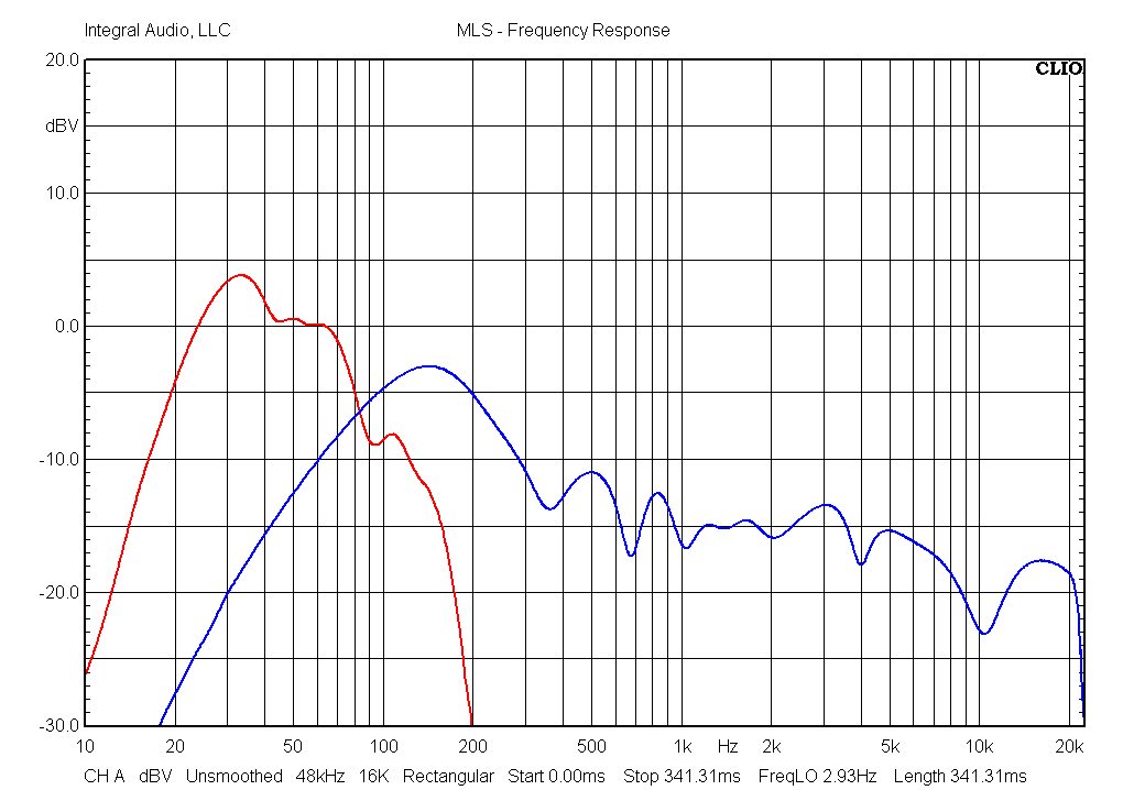

I applaud your ambition, but that's going to be a lot of effort for no benefit. EQ isn't going to fix it. If it were as simple as that, the Harman Becker engineers that designed the system in the first place would have just eq'd it differently - there is extensive DSP shaping of the existing output from the HK amp:
That's the electrical output signal of the HIFI amplifier with a flat input signal. What you see there is all of the eq that is applied by the amplifier, along with the frequency gating (crossovers). Blue = front midrange + tweeter, Red = front midwoofer.
Ignoring all of that, EQ isn't going to be of any help to you. There isn't enough power available in the HIFI amp to do any boost, so anything you did would have to be in cut, reducing your volume output. You can't eq away non-linear distortion. And those two things are far and away the biggest issues contributing to the overall quality of the HIFI system.

Thanks! I figured that it wouldn’t be all that effective, but it’s only temporary until I get better speakers and get the amps put together. I’ll be using the EQ then, so I might as well install it and get the inputs hooked up. That graph will be useful too
