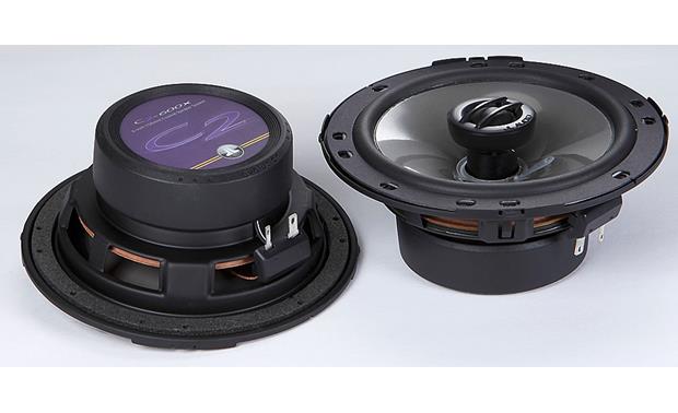

Right now... in place of the factory speakers, from the PO, there are JL audio coaxial speakers, of the proper sizes in both positions of both doors, no pillar speakers up front... Rear, JL Coaxial 6x9's in in the rear side panel factory locations.

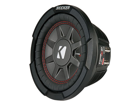

Kicker 6 3/4" CompRT 2 Ohm DVC Subs in the rear side panel locations in place of the 6x9's in custom CNC fabbed Heavy duty adapters.

I don't think I'd bother with the 6.75" "subs" at all to be honest. The 6.5" mid-bass from the component setup is probably pretty darn close in terms of bass output. I'd see about cutting or fitting an 8" sub at minimum, below that I think it'll have too similar of a range to your component drivers for the most part. The components won't go that deep - but I bet if you used the more powerful RF amp on them, they'd sound pretty good!
Out of curiosity - the previous owner replaced the stock speakers but didn't add a tweeter?? That seems pretty wild.
The PO put in Coaxial speakers... they have tweeters built into them.
CRUTCHFIELD:
JL Audio C2-600x
Woofers: The JL Audio Evolution C2-600x coaxial speakers feature injection-molded, mica-filled polypropylene woofer cones with butyl rubber surrounds. Each woofer has a 1" voice coil on a Kapton Former, a symmetrical roll spider and a Ferrite magnet.
Tweeters: Each coaxial speaker features a ¾" silk dome, ferrofluid-cooled tweeter with a damping neodymium magnet. The edge-driven silk dome tweeter is smooth, detailed (on or off axis), and provides great overall performance. Silk is lightweight and great for high frequency extension and efficiency. It is also designed for durability in the extreme automotive environment.
