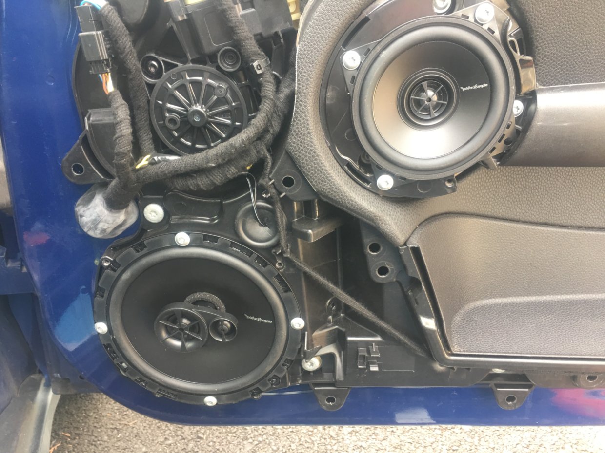

I have a '12 R56 & I just did an aftermarket radio & swapped the door speakers as a temp upgrade until I can get everything together to do high-end door components in the doors, replace the rear speakers & do an amp for it all & sub in the back.
Head Unit : Pioneer DEH-X8800BHS - I chose it for the time-delay, 4-volt outputs & front, rear + sub RCAs. I got it, the Dash Install kit, antenna adapter & the "chimes retention" harness all from Crutchfield. I chose to not also do the kit that retains the factory steering wheel controls because (1) the radio has not only a handheld remote, but iphone app for controlling it & (2) if I lose battery power for whatever reason, the "brain" has to re-setup & if it's buried in the dash, it's a pain to do so I decided against it for those reasons.
Door Midbass location : Rockford Fosgate R165X3 6.5" 3-way coax speakers. I chose these cause can't go wrong with Rockford & they were $35 on Amazon LOL
Door Upper location : Rockford Fosgate R14X2 4" coax speakers. I chose these also cause Rockford & $30 on Amazon.
I cut & spliced the factory speaker harness using a thread on here for the color configurations. Zero issues in clearance, though I did have to re-drill screw holes in the stock factory brackets for the 6.5" speakers. On the 4", I just used 3 of the 4 screws & bet the tab behind the door pull on the 4th tab on the speaker (see pic attached).
Until I can get my "real" system all together & installed, it sounds pretty good :D
